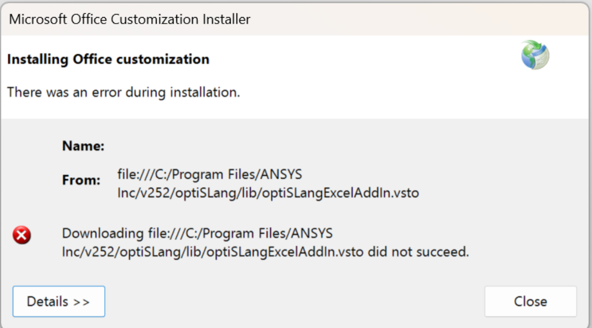

      I have installed the latest SpaceClaim 2025 R2 version, but now whenever i start up Excel i am getting the following error:
      I have looked in the options of excel and removed the references in the add in tab. However, sometime later i got the same error again.
      What can i do to solve this permanently?

      Also would like to know this, am seeing this a lot with 2025R2 when opening excel.
      The folder it points to doesn't exist

      Some users do not have access to the Excel add-in (developer mode) in administrator mode to remove it.
      One solution is to install optiSLang, but this complicates the installation process for customers who do not need it.
      Is there another solution, a known bug, or a service pack that fixes this?

      To whom got their system administrator right,
      Here is how I get rid of the error.
      Start excel in administrator by right click excel and select run as administrator.
      Follow the microsoft guide to remove all Ansys optiSLang plugin(I got 3).
      Close the excel and try start excel as normal. Should be error free.
      For those without their admin right. I afarid you will need your system administrator help.
