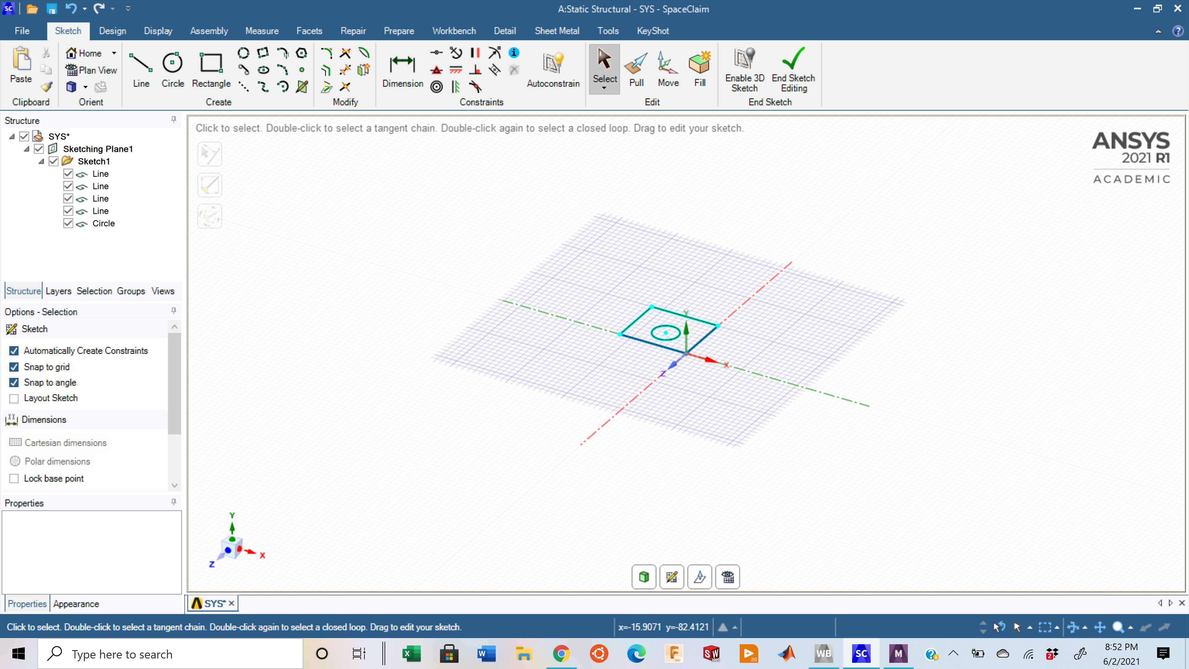

SubscriberI'm having issues with spaceclaim and ansys mechanical. When I use spaceclaim, the items listed in the structure tree dissapear when I move my mouse over them, and even sometimes duplicate. Below is a screen shot of how it should look:

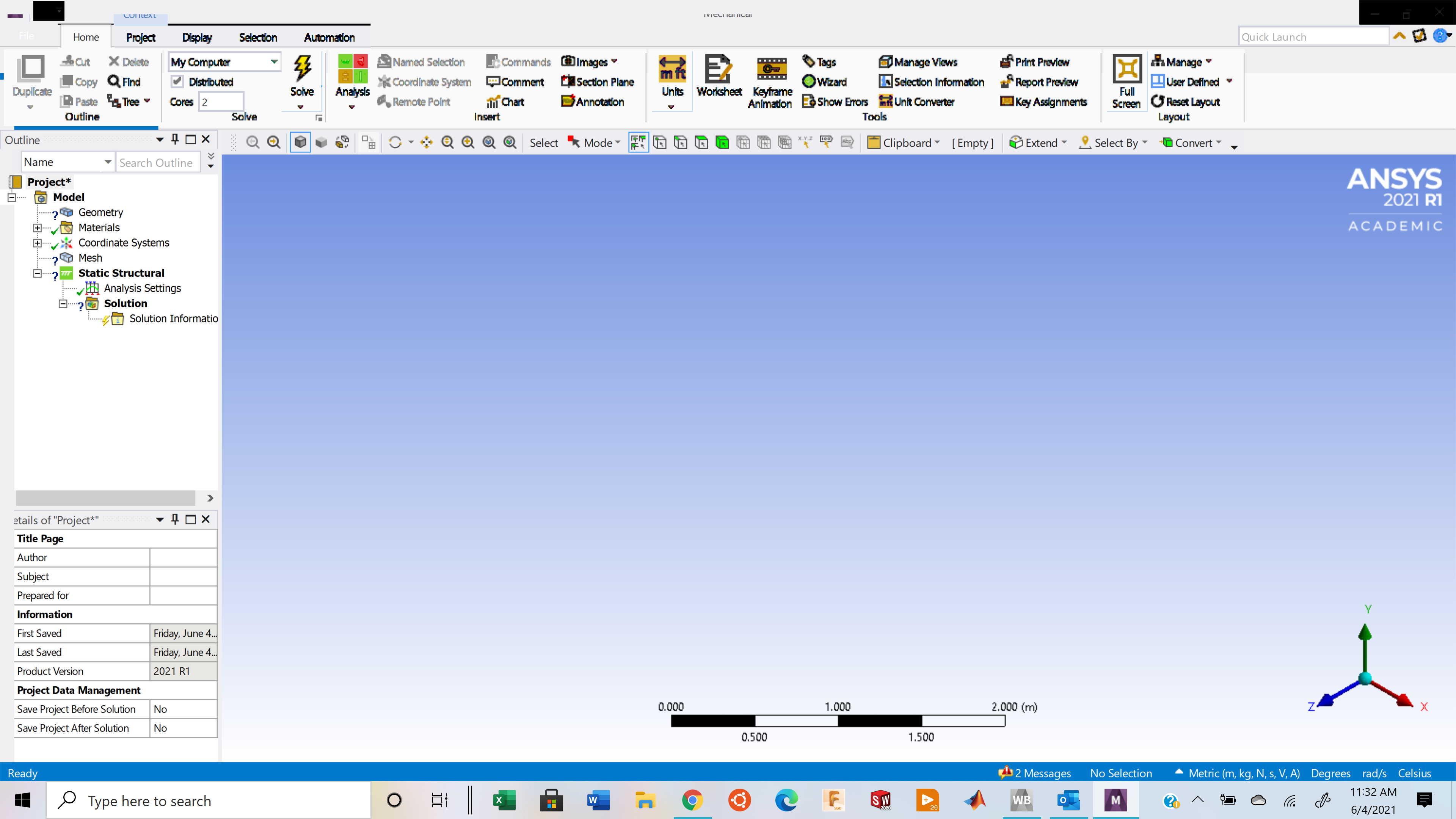

SubscriberI set the preferred graphics option to my Nvidia card, and I set the OpenGL to my Nvidia card as well. I restarted my computer and spaceclaim is still doing the same thing. Mechanical is still having issues as well, the top of the window title is cut off and the x and maximize buttons are black until I put my mouse over it. The issue with mechanical doesn't really effect my workflow, but the issue with spaceclaim does a lot.

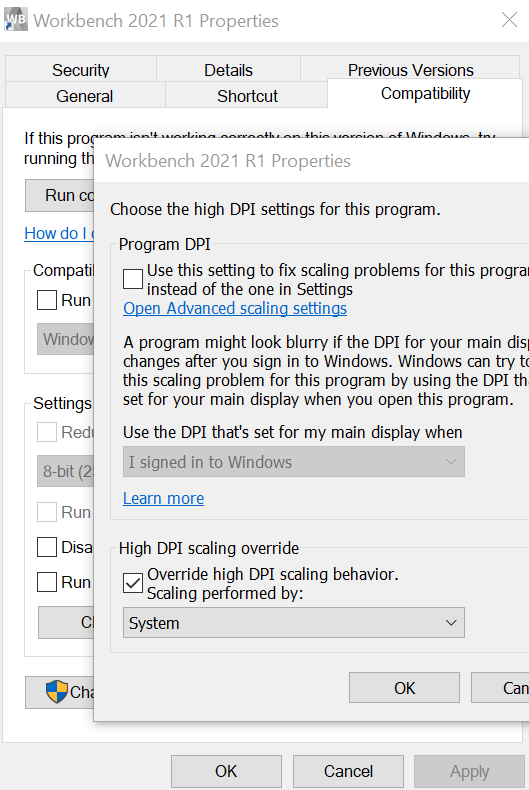

June 4, 2021 at 3:58 pmpsamario88
SubscriberChanging the workbench properties as you showed above solved both the issue.
