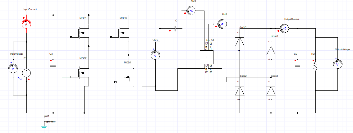

      Hello!
      I have designed a Wireless Power Transfer system and now want to co simulate it in Simplorer/Twin builder but the output current is zero. I think there is a problem with the src and snk of the transmitter and receiver, They're not properly configured. Suggestions needed!

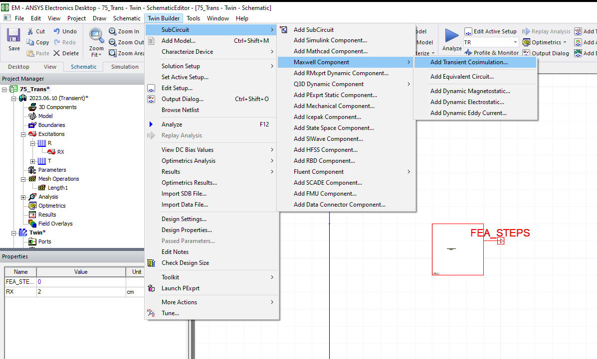

      I am trying to do a Transient Co simulation. When I insert a Maxwell component, i get a box ""FEA_STEPS". There are no pins for the Transmitter and Receiver.
