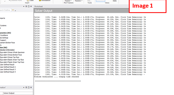

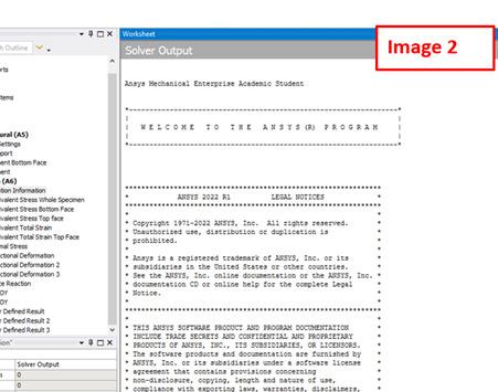

      Hi Everyone,
      I performed an Explicit Dynamics analysis and when I go to the Solver Output (in Solution Information) I get only some cycles info as well as times (please see image 1 below), without any other information about the process. Could you please advise? The issue does not exist in Static Structural analysis (please see image 2 below).
      Thank you.
      Costas
    • Ram Gopisetti
      Hi Costas, check the admodel.log in the solver file directory to see the full information of the solver outout
      Cheers, Ram
    • Costas
      Hi Ram.
      Many thanks for your reply. I tried to open the file which opens a folder containing relevant files. I opened the: admodel.prt (which contains information about materials, boundary conditions, energy etc.) and admodel (which gives the cycles timing). I also tried to open admodel.sum but it cannot be opened in a readable encoding. So, I cannot find details regarding element type (I found the number of elements but not their type). Any suggestion?
      Thanks,
      Costas
