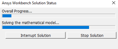

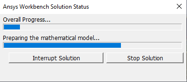

I found myself in kind of difficult situation. The thing is that I am learning Ansys and it has been no smooth ride so far. After I thought I fixed all of the issues I tried to solve the model and it just gets to around 30 % and then it keeps on repeating these steps:
I honestly don´t know where is the mistake. Could you guys help?

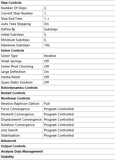

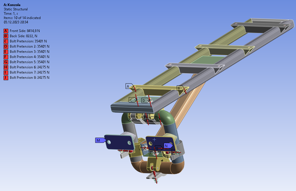

Here are some snapshots of the model I´m working on. In a nutshell it is a rig that should hold seats inside a tram and I have to check if it is safe enough. My analysis settings are these:

Ansys EmployeeCheck the Solution Information to see what is happening. In addition to Solver Output, Force Convergence is usually informative. To see if the model is completely connected perform a modal analysis. If a part isn't fully connected it will produce a zero frequency mode that will indicate the unconstrained motion. Â
