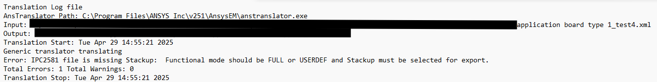

      Have followed the Ansys recommendation to use IPC2581-B, USERDEF with all boxes ticked except "Export Cross Section Data Only".
      When importing into SIwave:
      Logfile says:
      Looking into the xml-file, it does include stackup information. It can also be opened in free IPC2581 viewers with stackup data present.

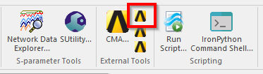

      Try using the SIwave PinToPin utility found in the "Tools" tab in SIwave for the import
    • ludvig
      Thanks for your suggestion. Using PinToPin gives the same error.
