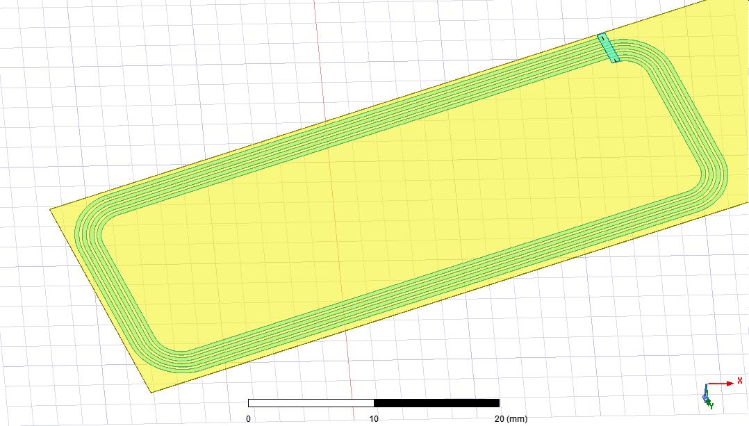

 Somebody could help me?
 I am using desing HFSS (DrivenModal), a primitive PolygonHelix to design a flat coil, using the basic standards of antenna design. I use a triangle as an excitation port (Lumped port). I also create a radiation box, a setup (560 hz) and an analysis frequency. I simulated the coil with 10 turns, although I would like to vary the number of turns later, however when compiling it works well but when analyzing everything, the answer is as shown in the images. Any suggestion.

Hi Iris,

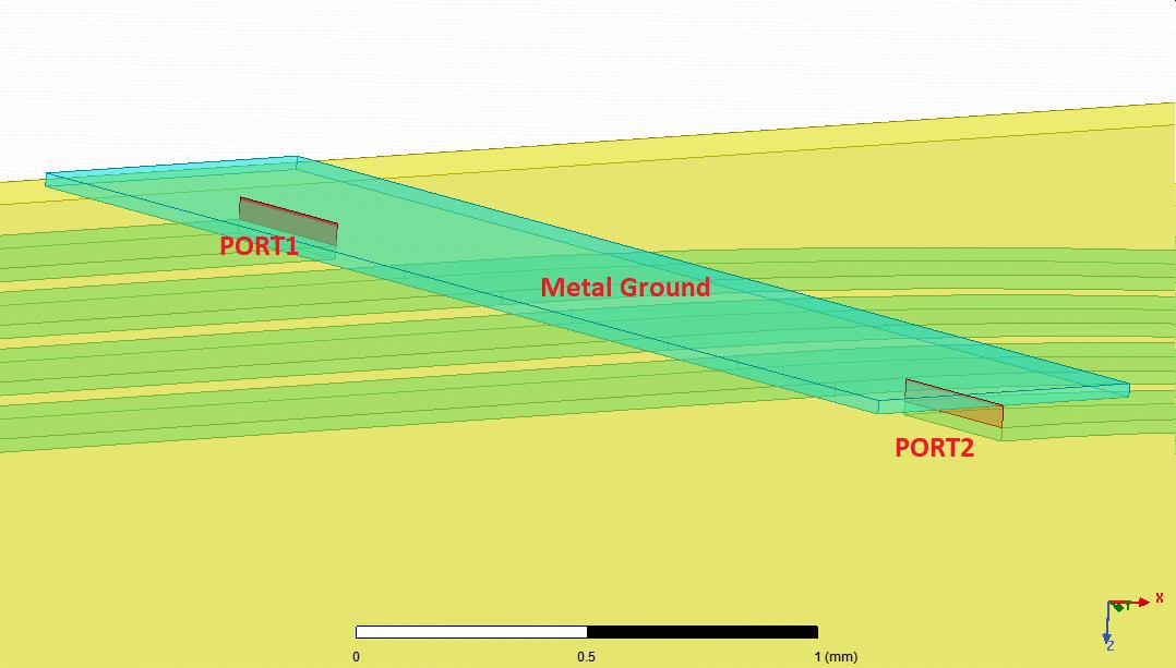

It is not clear how you are implementing the ports, I guess, it is where you have the issue.
In all HF Simulation Softwares as HFSS you need to define the Ports in a consistent way, I mean, they always must connect the Active part to the Ground. In the Coil case, you have to 'end parts', and you should connect both.
In the following case you can see what I meant:
As you can see, the 2 ended parts are connected with a metal plate and the corresponded ports:

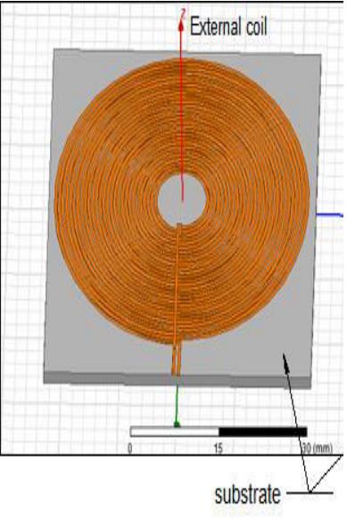

If you want an antenna with only 1 port, you can perform the following Setup:
As you can see a metallic trace has been created from the inner part to the bottom part, after this you can connect with one port the inner to the outer coil.
This would be the most efficient setup for a coil, once you have it, please check if HFSS performs correctly the Mesh. As HFSS Users we have to know how the antenna is modelled and created in real life to perform the most accurate model (materials, how the antenna is excited...). HFSS then will obtain the most accurate result.
