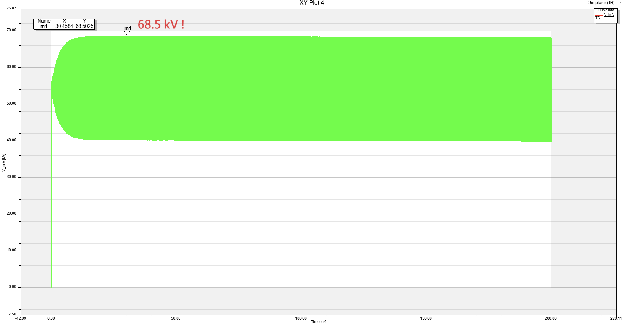

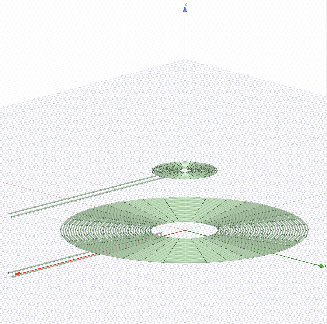

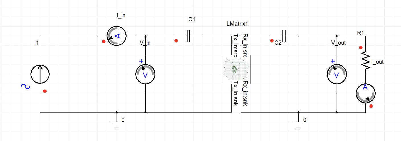

I am trying to verfify the simulated voltage of the Tx (big coil at the bottom) with hand calculation.
From Maxwell, the self-inductance of the Tx coil is 3.18e-4H.

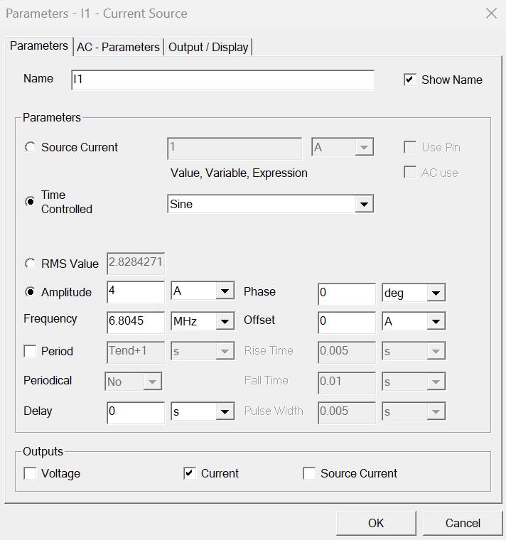

The source applied is Alternating Current 4A, with frequency 6.8MHz (6.8e6 Hz).
Then simulation was completed with result below.Â

1). I = Vrms/Z, where Z=r+Lf,
Vrms should equal: 4*(3.18e-4 * 6.8e6) =Â 8649.6V, assuming zero internal resistance r.
2). Vrms= Vpeak * 0.7071
so Vpeak = 8649.6/0.7071Â =Â 12232.4VÂ !
Can someone here rescue me please?Â

Ansys EmployeeHi, what type of winding is used in Maxwell excitation. solid or stranded winding? For solid winding type, resistance will be considered.
