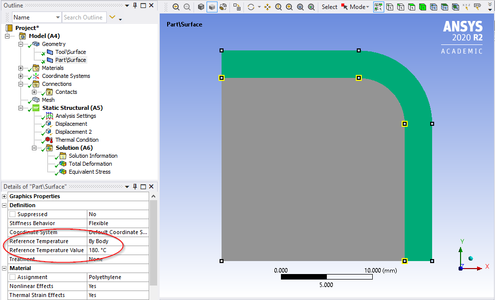

SubscriberHello, I tried this. However i am running into a problem. I run the thermal simulations and get the temperature distribution and run the static structural. But here is a tricky situation, one of the my parts is cooling down from a higher temperature to lower and other part is going from a lower temp to higher. So one body should be shrinking and other expanding. But currently all bodies expand in my Ansys simulation. Im guessing this is because it takes the starting temp as ambient and then the temperature from the thermal analysis as the final state.
Is there a way to define different initial temperatures to different parts of the assembly and then give the temperature distribution at the end ? Basically a shrink fitting kind of analysis.
December 22, 2021 at 4:31 pmpeteroznewman

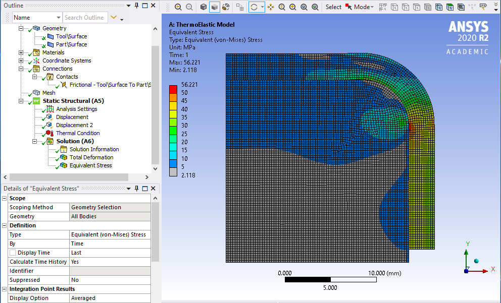

SubscriberHere is a simple model of a shrink fit. The Polyethylene part has a Reference Temperature of 180 C, while the Tool part has a Reference Temperature of 22 C.
The model has a Thermal Condition of 22 C. That means the plastic part will cool down from 180 C to 22 C in the simulation. There is a frictional contact between the two parts in the 2D axisymmetric model. You can see that the part is shorter when it cools, and is being stretched by the tool, which did not change size as the temperature on it did not change.
