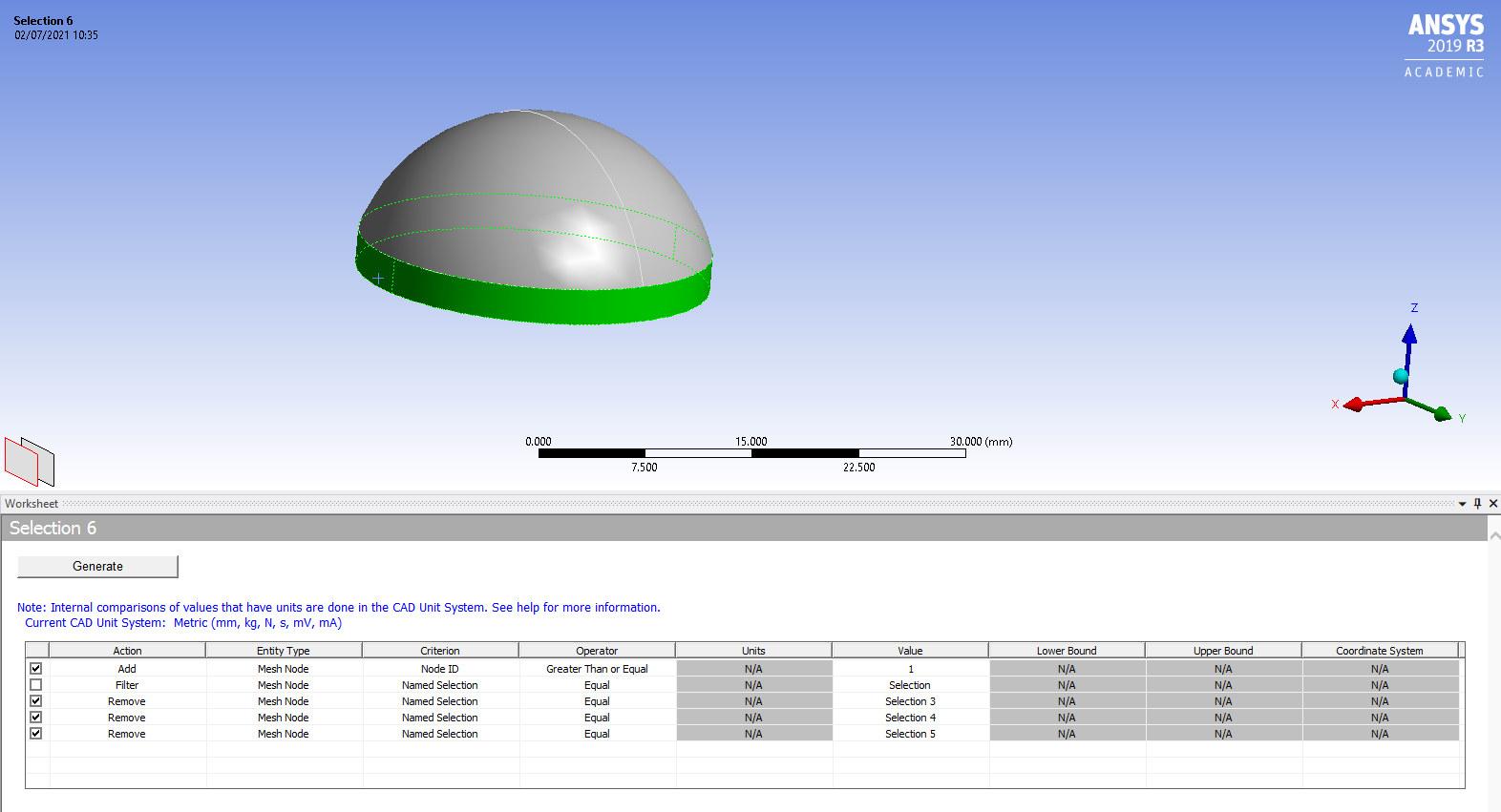

"You can make a Named Selection of all the nodes on the the front surface and another Names Selection of all the nodes on the back surface." when generating a named selection, how do I filter out the nodes on one surface? I see the following options in the selection worksheet but I do not see a combination of the various options to have a filter that gives me nodes only on the surface.
To select the nodes on the convex surface, what I am trying to do is, first select all nodes in the Add step. Then remove the nodes on the faces grouped into a named selection one by one. There are three faces which needs to be removed (two highlighted green faces and one flat face at the bottom). However the generate button does only what is expected of the ADD step and nothing else. Is it because there are shared nodes between the convex faces and the highlighted faces that ANSYS is not able to remove the nodes?

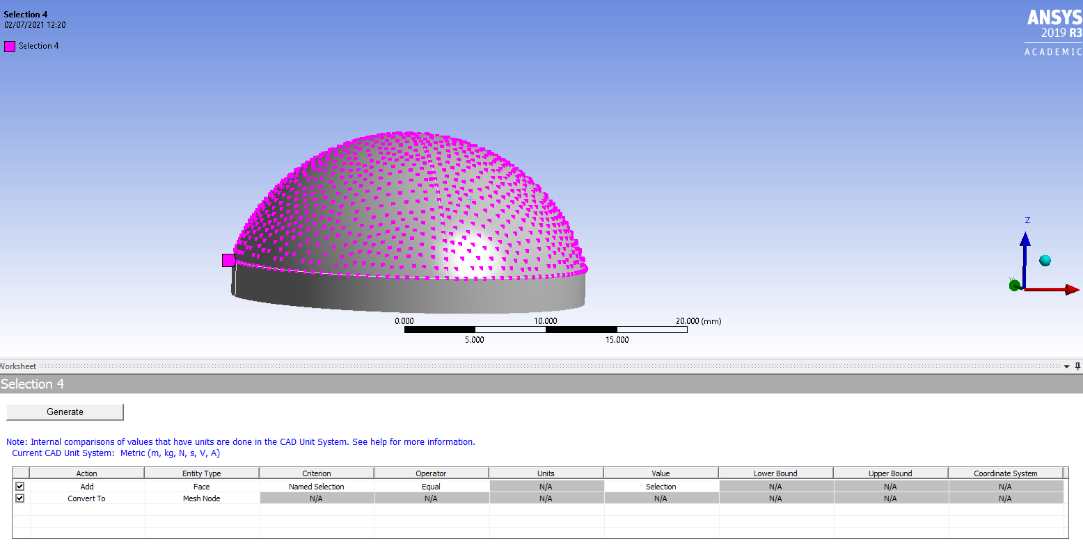

SubscriberHello Amit Nodal Named Selections are tricky, glad to see you figured it out.

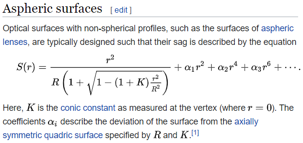

Optical surfaces are typically defined using a Sag equation.
A spherical surface is defined by the Radius of Curvature R and the Diameter D. I would replace D/2 with r in the equation below because if you have the X,Y coordinates of a node in the coordinate frame as I described above, then the value of r is simply the square root of the sum of the squares, and the Z coordinate is the SAG.
CAD systems can create a perfect spherical surface, so it is likely that the nodes in the model lie exactly on the surface defined by this equation.
Many optics use an aspheric surface https://en.wikipedia.org/wiki/Sagitta_(optics)
The optical design engineer would provide the coefficients in that equation to the mechanical design engineer/analyst who can recreate the surface precisely.
The CAD geometry you have may not precisely match this sag equation if it is an aspheric surface. It is a good idea to check the deviation of the sag of each node location from the sag value calculated from the equation and provided coefficients. The error should be less than a small fraction of a nanometer.
