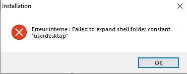

      SCCM (MECM) uses the local SYSTEM account to install applications.
      ansys-rockybundle-bin-22.2.0-win64.exe wont install correctly using the switches /SUPPRESSMSXBOXES /SILENT /NOCANCEL /NORESTART
      We get 3 of these:
      And this one:

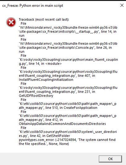

      This last one is cause by an action of the Rocky installer:
      "C:\Program Files\ANSYS Inc\v222\Rocky\bin\fluent_coupling.exe"
      This action is the last action of the Rocky installer (innosetup) and will fail under the system account.
      To reproduce, use sysinternals psexec.exe
      psexec.exe -s -i cmd
      to enter a Command Pompt under the local SYSTEM account.
