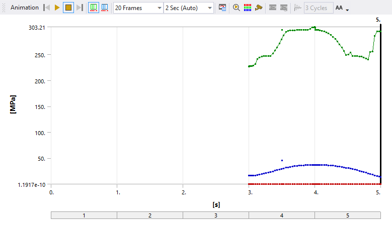

      Hi Everyone,
      iam running an analysis having 5 load steps, out of which 3 load steps has converged 4th has failed, so i decrease the load and gave the run again and it solved.
      but now the result is showing only from the 4th and 5th load steps only,..
      iam unable to see the Results for 1 to 3 load steps, how can i get these back..also there is a failed sub step result exist in this,..

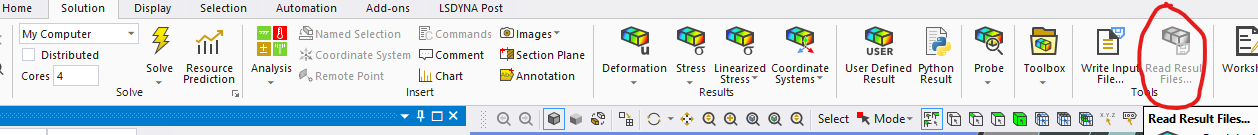

    • ashish.khemka
      Hi Chandan,
      Can you please open the solver files directory and see how many result files are there (.rst file)? To open soler files directory please refer to the snapshot below:
      Ashish Khemka
    • DEVICHANDAN.PADALA
      Hi Ashish,
      i have seen File.rst, File0.rst, File1.rst, File2.rst and File3.rst, total of 5 .rst files in the solver file directory.
      my problem is i can run the analysis again, but it take 36hr to solve full model, if there is any possible way to extract these it would be helpfull for me.
      thanks in advance.
    • ashish.khemka
      Hi Chandan,
      Different rst files correspond to different load steps. You can read the .rst files and plot the results. On the ribbon bar go to Solution -> Read Result Files and import the .rst (in proper unit system, check solver output for unit system in which model was solved) and then plot the results.
      Also, Ansys EnSight can be used to view the results: 2 - An update on outputting results in Ansys Mechanical: Taking it to the Next Level with Ansys EnSight - PADT (padtinc.com)
      Ashish Khemka

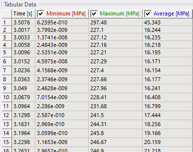

      hi ashish,
      thanks for the reply,..
      i have tried that process as well, but unfortunately iam able to generate results of 4th and 5th load steps only it is not reading from 1 to 3 steps,.. even if i try to plot the stress b/w 1 to 3rd load step it is ploting the end results of 5th step only.
      what is the use of Recover results option in restart analysis..?
