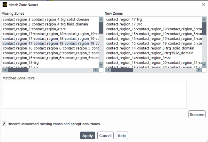

SubscriberHi! I am currently using the Response surface optimization software paired with the fluid flow (fluent) to determine the most ideal input parameters. To achieve so, I am required to create meshing for both the solid domain (microchannel fins) as well as fluid domain encompassing the solid domain. However, when I run the DOE, I am always met with an error. I have identified the error mainly as the contact region between the fluid and solid domain changing whenever the input parameters change (including change in angle and length of fins), which results in the
stage of the process being unable to manually match the zone names of the changed contact points. Is there a way to get to automatically match the new zones names, or other ways to solve this issue. Thanks

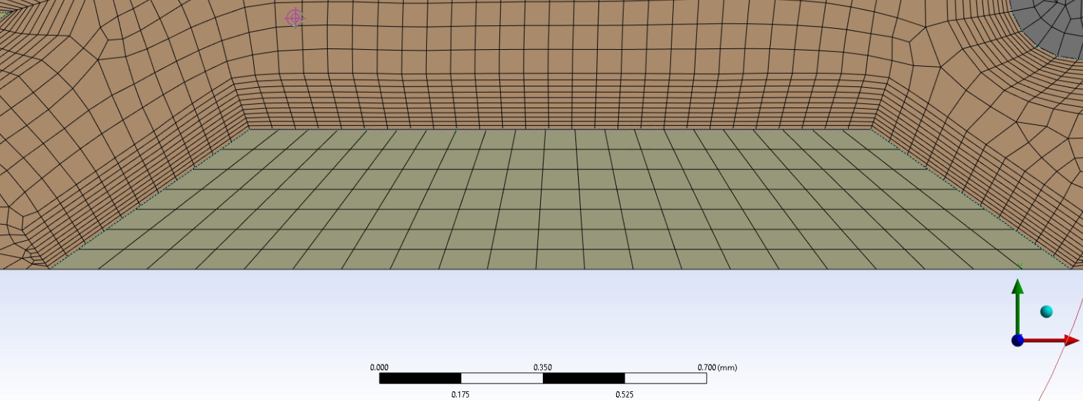

Not sure if this is what you were looking for. but here is part of the mesh profile. This is a screenshot taken from a top down view, and there is no changes along the Z axis. The light brown and grey shapes are the solid fins while the darker brown region with the inflation is the fluid domain. Generally all the fins used are similar to the one seen below. The Geometry was done on design modeler and the fluid domain was generated using the enclosure feature

Forum ModeratorEnclosure can be a fun one for not splitting over objects, and you then need to make sure you have a multibody part. That should resolve the contact problem(s). In meshing you also need to fix the the way the inflation terminates around the yellow body - left hand end. Cells that shape aren't going to improve your model stability. Check inflation advanced options, there's a project or angle option in there somewhere. You also want to review the course notes on jumps in cell size, inflation mesh has it's uses, but you can also add problems into the model with them.Â

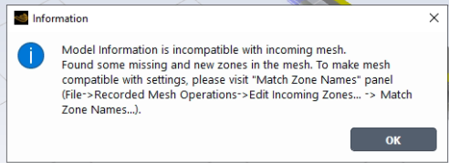

This isnt actually meant to be as detailed, as i intend to use the data from the response surface optimization process to narrow down to few dimensions before coming up with a more detailed gemoetry and meshing. However the main issue that i face is that the fluent process is unable to auto update the change in contact regions between the fluid and solid domain whenever theres a change in dimensions of the fins, not so much that of the mesh process. Not sure if that can be solved.

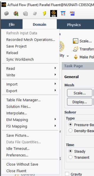

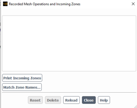

edit: this is an example of the error i get when i change the width of the fin, the error i receive is a result of the contact points between the solid fin and fluid domain shifting and ansys fluent is unable to register it. It requires me to manually go to
, and to update the changes in contact regions, before i am able to proceed with the calculations Â

Forum ModeratorThere may be a slight difference in labels in the interface zones, and that can break the parameter updates. A conformal mesh should reduce the chances of problems.Â

Forum ModeratorFluent will complain the first time once the interface zones are removed and then should work as intended. The root issue is the boundary ID may not be retained for every change, and that confuses the workflow.Â
