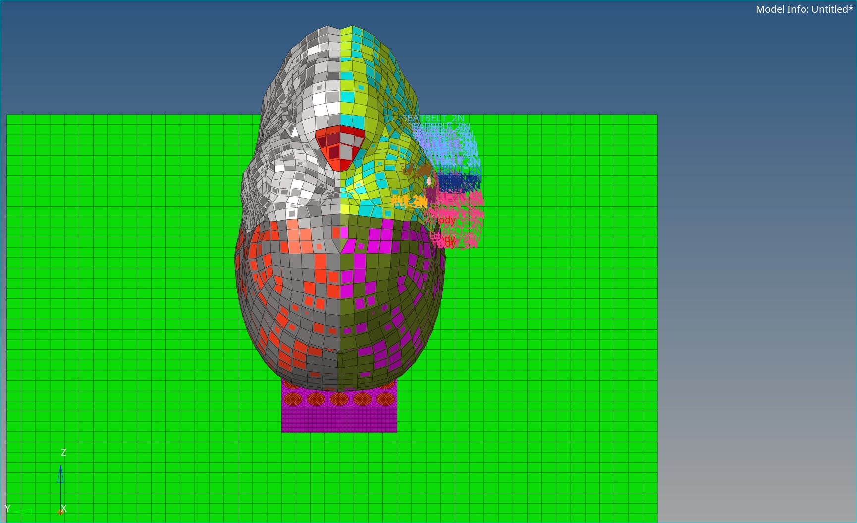

Subscriber I am attempting to replicate the experiments from the paper (10.1002/adem.201700059) using LSDYNA, but I have encountered a bottleneck. When modeling the composite density matrix/fiber structure of EPS40/120, I consistently run into the issue of negative volume. I have already tried several material models: MAT63 (no error reported, but the experimental results do not match at all), MAT83 (negative volume error), MAT142 (negative volume error), and MAT126 (negative volume error).( *** Warning 40630 (SOL+630)
   negative volume in solid element # 2620544 cycle 197 time= 1.8696E-05)

Ansys EmployeeHello User,
Have you tried the general guidelines to handle negative volume error?
Strategies to Overcoming Negative Volume CalculationsRegards,
