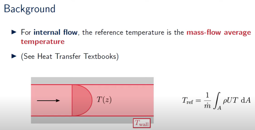

SubscriberHi,I have a 2D, steady state, laminar internal flow problem. I think the calculation for laminar flow HTC is: HTC = q / (T_wall - T_ref); where T_ref is the reference temperature. What I'm stuck on is how to define this reference temperature for my problem. This video says that for internal flow problems, the reference temperature is the mass weighted average (see attached image), but how can I calculate this integral?Thank you -

Forum ModeratorHave a look in the volume reports, but "mass flow average" implies a surface report. The best option is to read the User's Guide chapter which covers the HTC definitions as Fluent has 3-4, the one you want depending on what you're doing. There's a reason we generally report a heat flux!

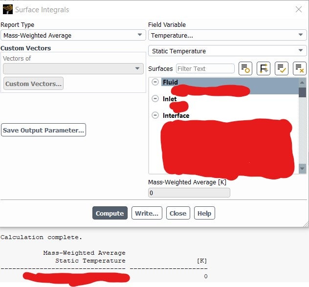

SubscriberSorry, I've had to cross the names out as per my mentor's request *sigh*

Forum ModeratorDon't report on the fluid surface, that's what the Volume reports are for. Zero Kelvin shouldn't be able to happen as the solver is limited to 1K. What happens if you plot temperature contours?

SubscriberThank you for your reply! So I outputted both the surface and volume mass-weighted average temperatures and for some reason the former outputs 0 K and the latter around 400 K. Shouldn't they be the same value for a 2D simulation?

Forum ModeratorSort of, I'm not sure what will happen in solid zones with mass weighted for a surface report: technically a surface mass is the flow mass, so it gets a little weird.

Forum ModeratorIf you're using a current release they should be the same (user error permitting), in an older version of the code there was a glitch. I'd need to see images of what you have selected when reporting & the results.
