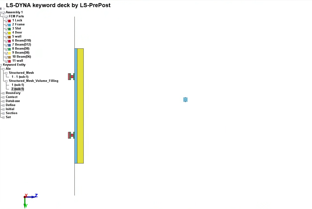

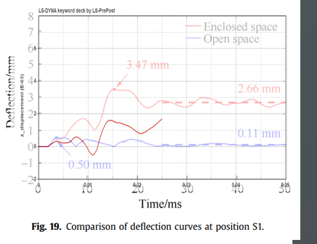

SubscriberWhen simulating an RC blast door using SALE (ALE–FSI) in LS-DYNA,
the time-history trend of the door deflection matches the literature, but the peak displacement is significantly smaller.
 Peak deflection Literature 3.47 mm My model < 2.0 mm So the response shape is correct, but the amplitude is underestimated.
Model summary
Geometry
RC door thickness: 100 mm
Door location: z = 0–0.1 m
ALE domain: z = -0.6–3.4 m
Explosive
TNT: 0.15 kg
Half model with symmetry plane at x = 0
ALE mesh
10 mmÂConcrete
MAT_072R3 (KCC)
f'c ≈ 19.7 MPaÂReinforcement
ÂMAT_PLASTIC_KINEMATIC
E = 200 GPa
ETAN = 1e9 PaEmbedded using:Â CONSTRAINED_BEAM_IN_SOLID_PENALTY
Solid elements
ELFORM = 1ÂFSI coupling
ÂALE_STRUCTURED_FSI
LSTRSID = 1
(part set includes parts 1,2,3,4,5,11)
PFAC = 1
FLIP = 0ÂContact
Door–frame interaction:
ÂCONTACT_AUTOMATIC_SURFACE_TO_SURFACEÂFrame is located behind the door and initially touching the door rear surface.
Friction:
FS = 0.2
FD = 0.15ÂTests already performed
ALE backside domain
Âz = -0.6 → -0.3ÂNo noticeable effect.
Beam–solid coupling parameters
Adjusted penalty parameters → no noticeable effect
Frame-wall connection
Removing shared nodes → response trend became worse
Question
In ALE–FSI blast simulations, when:
pressure history appears reasonable
displacement time-history trend matches literature
but peak displacement is underestimated
what are the most common causes?
In particular, I would like to ask:
Could the door–frame initial contact (rear surface initially touching the frame) act as an early support condition and reduce the door bending deformation?
Any suggestions or similar experiences would be greatly appreciated.
