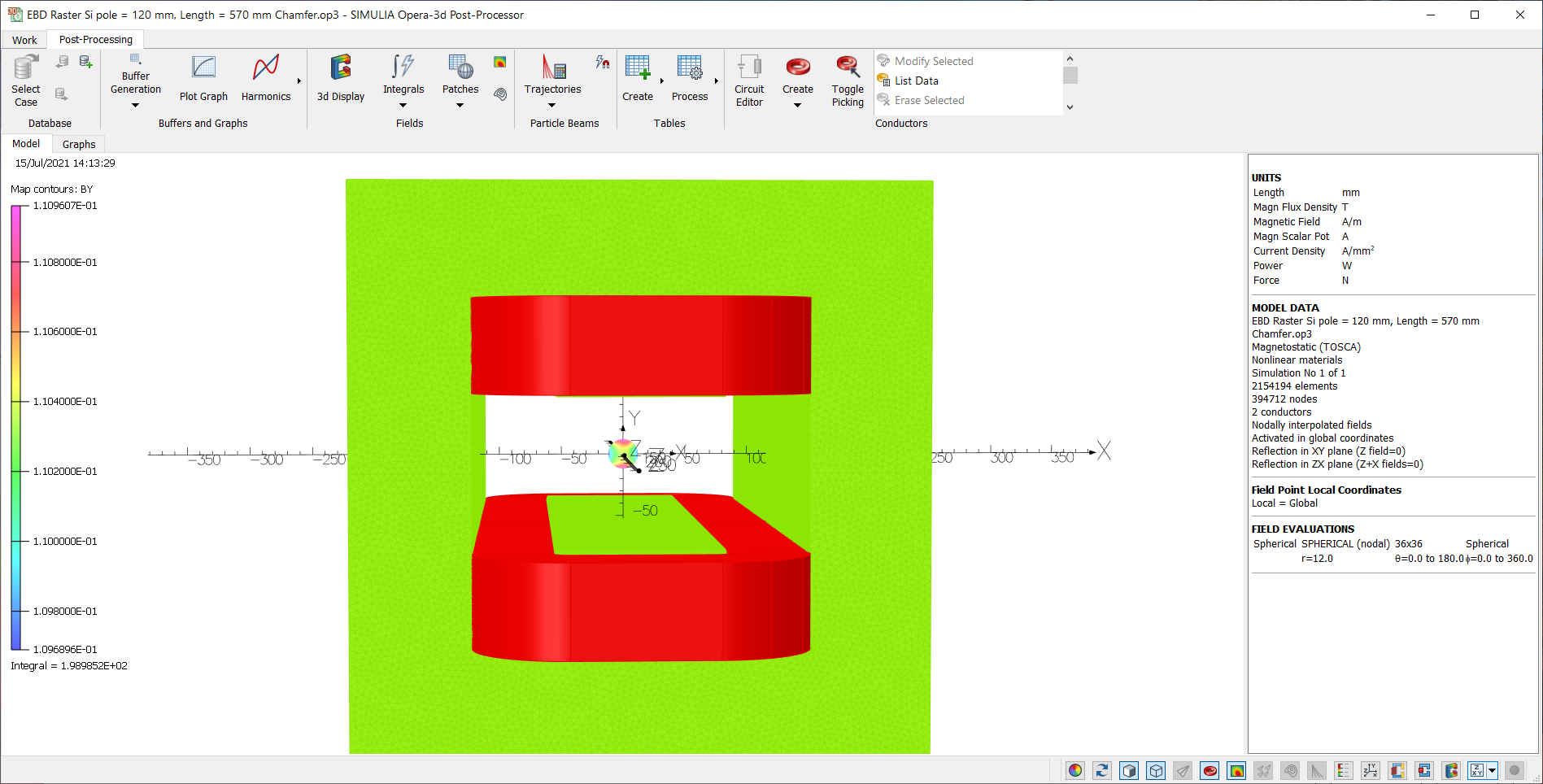

SubscriberI was wondering if anyone has made or knows where I can get a Maxwell primative for a racetrack coil for a accelerator dipole? This is a very common coil used for accelerator dipoles. It looks like the coil in this model.

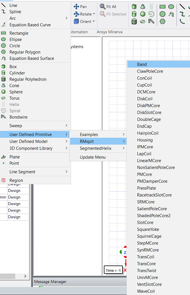

SubscriberThat is too bad. This is a very basic coil design that is used in most accelerator mangets and it would be nice to have this an UDP. If I did have this I could use Maxwell instead of Opera. Thanks for the info.
December 29, 2021 at 8:01 pmJanuary 25, 2022 at 6:16 pmsda

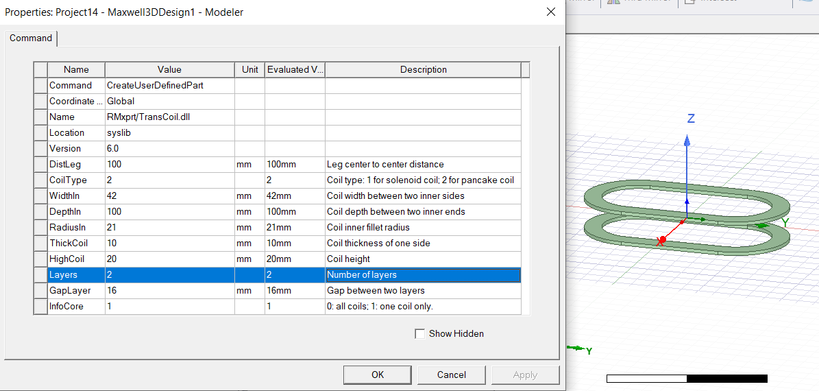

SubscriberThanks, the TransCoil is what I've been looking for.
