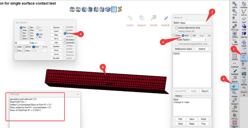

    • wangbb
      Hello Nanda,
      Regarding the mass, the situation is, I need to set a constraint on the mass in HyperStudy, so I need to invoke a output file (such as binout) to input the mass.
      However, I don't know which keyword can generate the mass into output file.
    • Nanda
      Hello Wang,
      That's refreshing to hear. As far as the mass part, I'm not sure if it can be outputted in any separate file. What is HyperStudy? What kind of inputs does HyperStudy accept?
      Is d3hsp file not helping?
      Nanda
