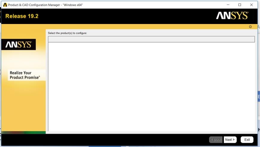

Product and CAD Configuration Manager – No Products Displayed
    • ScottHumphreys

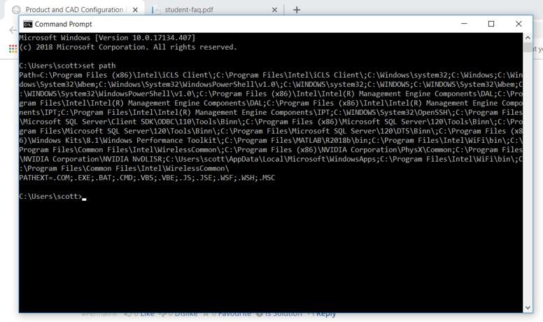

      I have installed ANSYS for students 19.2. I can run workbench but when I try to enter the DesignModeler to create geometry it fails and says "The geometry editor was closed abnormally". I have seen several other threads discussing a similar issue, and I have uninstalled, reinstalled, changed file names, etc. as suggested. When I run the Product and CAD Configuration Manager and select Configure Products and CADs, no products are displayed at all, which makes me think there is something wrong with the installation.

      Hi ScottHumphreys,
      Check your installation directory (e.g., C:Program FilesANSYS Inc  or   C:Program FilesANSYS IncANSYS Student) and see if you have the file named install.err. If so, please post its content here.

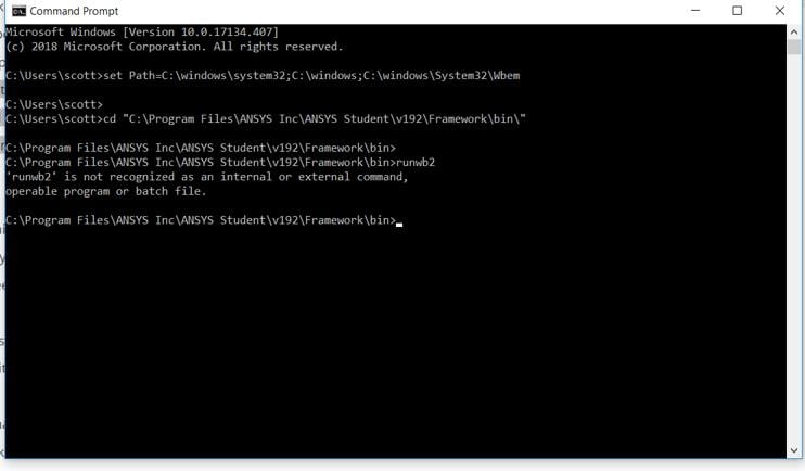

    • ScottHumphreys
      Hi Win,
      There doesn't seem to be a file with that name in the installation directory.

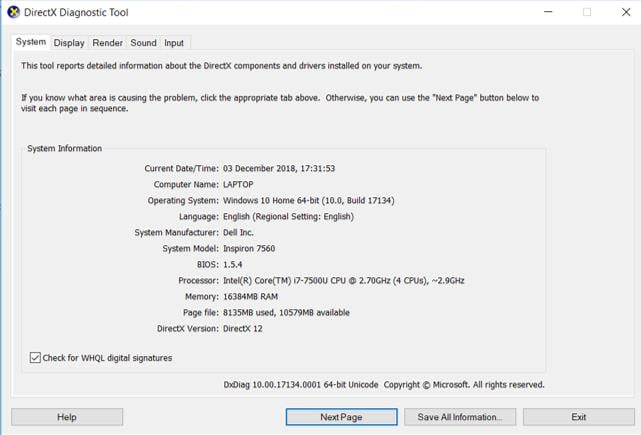

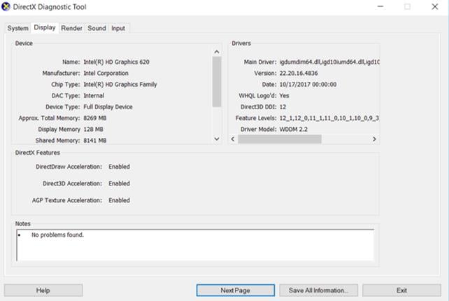

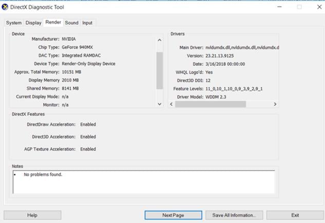

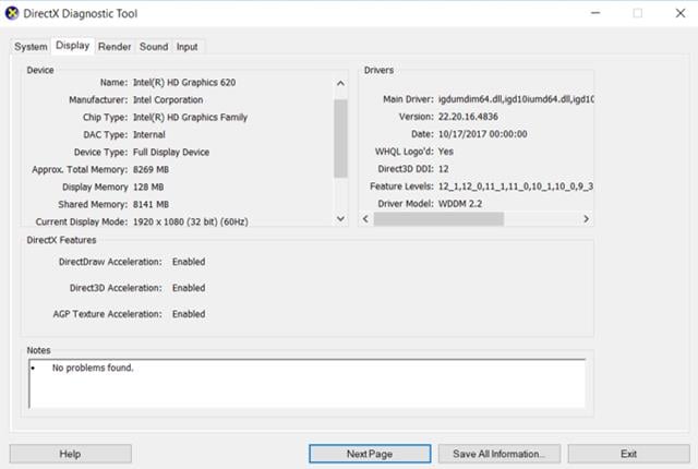

    • JakeC
      Hi ScottHumphreys,
      Please make sure your graphics drivers are up to date, and that you have the High Performance Card set as the default.  For example if running an nvidia card:
      Nvidia Control Panel -> Manage 3D Settings -> Global Settings -> Preferred graphics processor -> High Performance NVidia Processor
      If that doesn't help please send a screenshot of each tab of from the dxdiag.exe application:
      Start -> Run -> DxDiag.exe
      Thank you,
      Jake

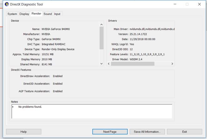

    • ScottHumphreys
    • JakeC
      Hi ScottHumphreys,
      Your Nvidia and Intel drivers are very old.  Please update those to the newest versions.
      Once complete, reboot, then set the following:
      Open Nvidia Control Panel -> Manage 3D Settings -> Global Settings -> Preferred graphics processor -> High Performance NVidia Processor
      Thank you,
      Jake

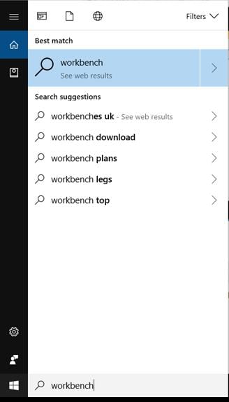

    • ScottHumphreys
      I also cannot find any of the ANSYS applications by using the search bar in Windows. I have to locate the ANSYS folder and run from there.

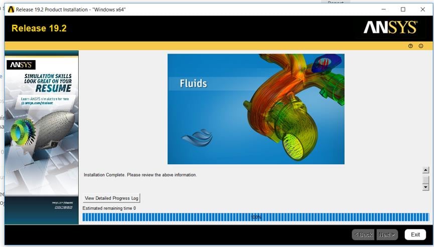

    • ScottHumphreys
      The installation window says "Installation Complete. Please review the above information." Can I click Exit now or will it close automatically? That may be a stupid question but I'm getting very frustrated so want to make sure everything is done correctly.

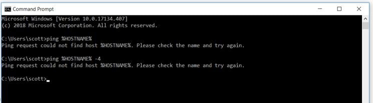

    • JakeC
      Please post a screenshot of the screen.  Also please click on the "Show Detailed Progress Log" button, and paste in the contents of that log.
      Thank you,
      Jake

    • JakeC
      Looks ok with the exeception of:
      C:Program FilesANSYS IncANSYS Studentv192CADConfigLogsCADConfigurationMgr.err
      Click exit, and post the contents of the the above file.
      Thank you,
      Jake

      It crashes when you try to open Mechanical/Mesher, is this still correct?
      Can you also open a command prompt (Start -> Type cmd -> Click Command Prompt)
      Then at the prompt type:
      set path
      Please post a screenshot of that screen.
      Thank you,
      Jake
    • ScottHumphreys
      "DesignModeler takes several minutes to open.

      I can open Workbench. I can find it in the program list in the start menu. It aborts when I try to open DesignModeler from Geometry.

      Ok lets try this:
      open command prompt
      type in:
      set Path=C:windowssystem32;C:windows;C:windowsSystem32Wbem
      cd "C:Program FilesANSYS IncANSYS Studentv192Frameworkbin"
      runwb2
      This will open Workbench.
      Try opening Design Modeler from there.
      See if that makes a difference.
      If so, there are some conflicting .dll files in your path.
      If it doesn't help please look in c:windowssystem32 and see if there are any .dll files that have "qt" in them.
      Thank you,
      Jake

    • ScottHumphreys
      It isn't recognising that as a command.
    • JakeC
      Sorry my fault.  The cd path should be:
      cd "C:Program FilesANSYS IncANSYS Studentv192FrameworkbinWin64"
      Then run:
      runwb2
      Thank you,
      Jake

    • JakeC

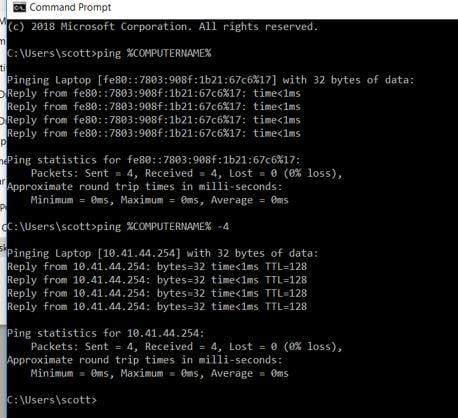

      Ok,
      From the command prompt please try:
      ping %HOSTNAME%
      And then
      ping %HOSTNAME% -4
      Then post a screenshot of the result.
      Also you can try editing the host file:
      c:windowssystem32driversetchosts
      and remove the "#" from the line:
      # 127.0.0.1       localhost
      becomes
      127.0.0.1       localhost
      Thank you,
      Jake

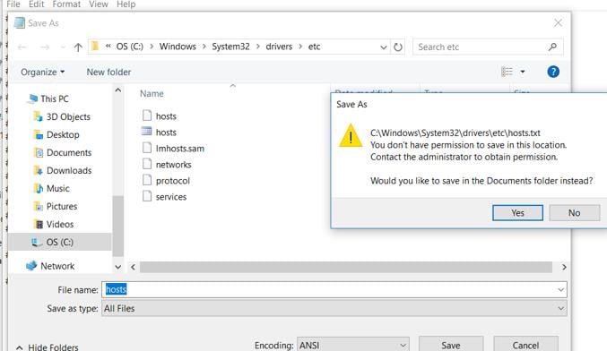

    • ScottHumphreys
    • ScottHumphreys
      That seems strange as I am an administrator
    • JakeC
      In those commands change %HOSTNAME% to %COMPUTERNAME% and see what you get with the ping commands.
      As for editing the hosts file, open notepad as administrator
      Start -> Type Notepad -> Right Click on Notepad -> Run As Administrator
      Then use File -> Open  to edit the hosts file.
      Be sure that it doesn't save as hosts.txt, its important that there is no extension on that file.
      Thank you,
      Jake
    • ScottHumphreys
      The ping cmd has worked now. Am I OK to share that data here? Is it not a unique code for my laptop?
    • ScottHumphreys
      I have changed the host file

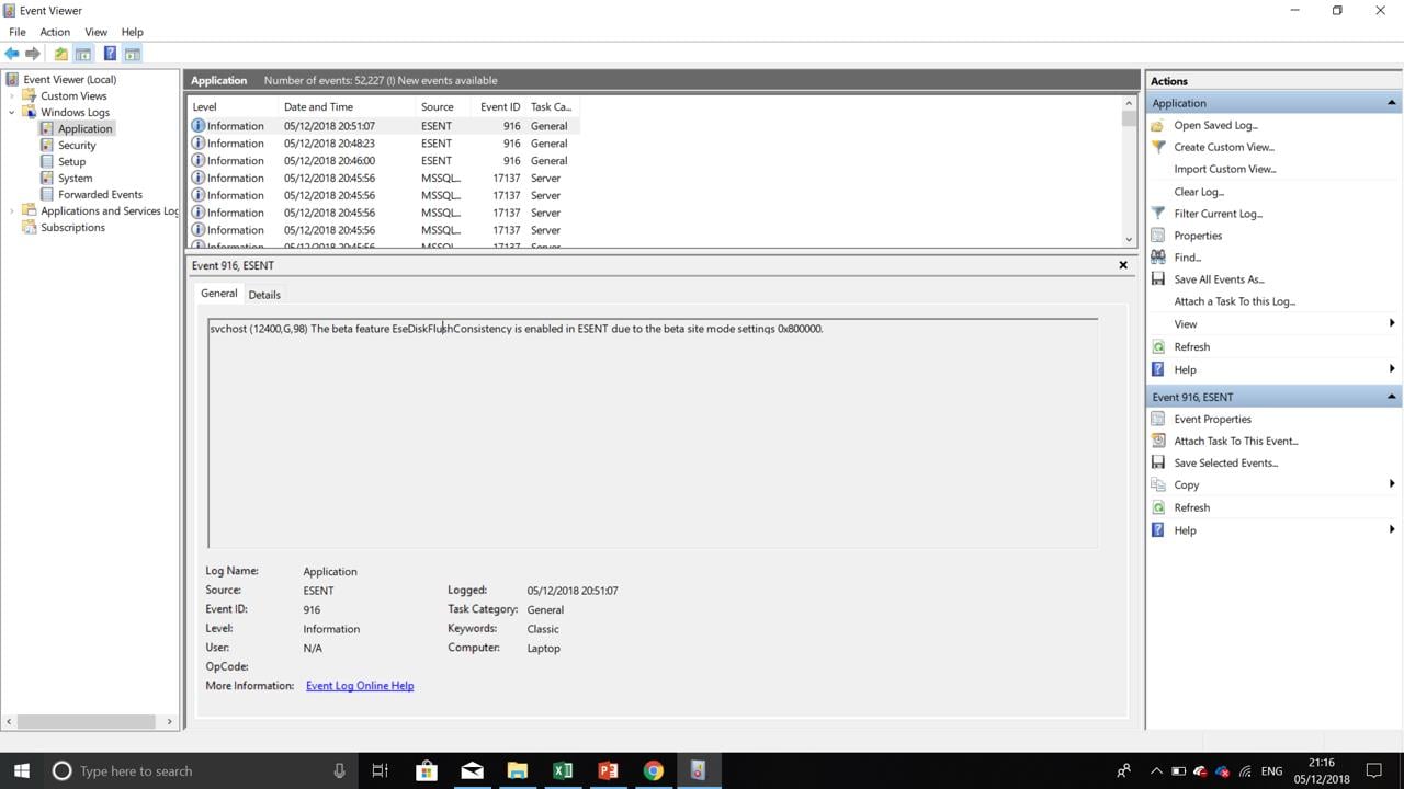

      Also can you open the Windows Event Viewer:
      Start -> Type Event Viewer
      Select -> Open Windows Logs -> Application
      Locate the latest Ansys crash, and post a screenshot of the "General" tab.
      Thank you,
      Jake
    • ScottHumphreys
      I really appreciate the help, thank you. It is getting very frustrating.
      It shows a grey screen for a few seconds and then crashes.
      I don't really know how to locate the latest Ansys crash. There don't seem to be any events corresponding to it.
    • JakeC
      Please post a screenshot of what you see in the event viewer.
      Thank you,
      Jake
    • ScottHumphreys
    • JakeC
      Maybe look in the "System" section.  But its probably not there.
      Can you post the "Display" and "Render" tabs again from DxDiag now that you updated the drivers?
      Thank you,
      Jake
    • ScottHumphreys
    • tsiriaks

    • JakeC
      Looks like your intel drivers are still old.  Please update those as well.
      Thank you,
      Jake
    • ScottHumphreys
      I have updated the intel driver. It didnt change that version date.

    • ScottHumphreys
      Interestingly workbench does appear when i type workbench in the windows search bar when acting as the new user. When i search from my main user it does not. It doesn't look like anything is working. Thanks very much for your time, Jake.
    • JakeC
      Windows 10 has some issues with updating the Start Menu database sometimes.  A new user forces a completely rebuild for that user.
      Can you try installing on a different machine, and see if you have the same issues?
      Thank you,
      Jake

    • tsiriaks
      Do you still have the issue with blank product config with this new user ?
      Have you tried this
      Manually register the DLLs listed below by starting a Command Prompt (DOS) "as administrator" and changing to the directory c:windowssystem32, then typing:
      regsvr32.exe ole32.dll
      regsvr32.exe atl.dll
      regsvr32.exe oleaut32.dll
      regsvr32.exe scrrun.dll
      regsvr32.exe jscript.dll
      regsvr32.exe vbscript.dll
    • ScottHumphreys
      I do still have the issue with the blank product config with the new user. I have just tried the manual registration thing. A couple of error dialogue boxes came up but it did seem to say some or all were successful.
    • ScottHumphreys
      Correction: oleaut32 scrrun and jscript failed
    • ScottHumphreys
      Apologies, I forgot to run cmd as admin, they all succeeded.
    • ScottHumphreys
      It seems to have worked! Thank you both so much!
