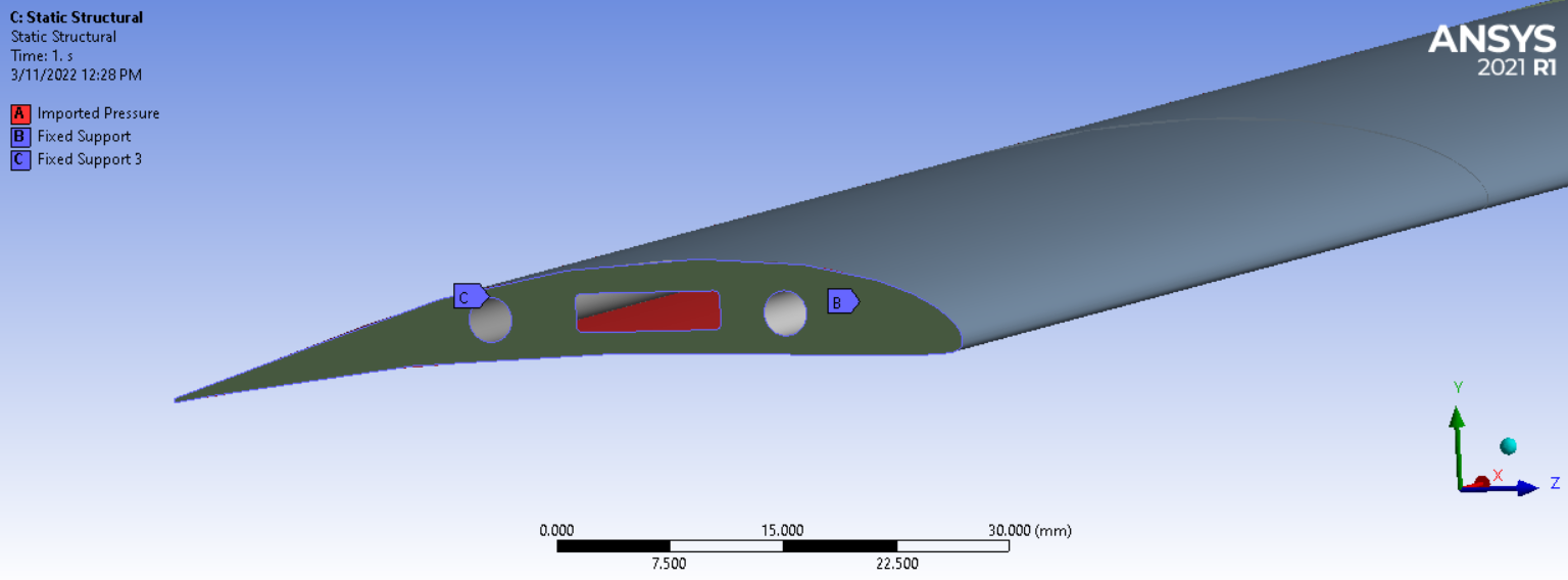

I want to solve this FSI simulation and I try to fix my model at the edge, but it don't solve. The elements that I use are 3D shell. The error message is the following:
*** ERROR ***Â Â Â Â Â Â Â Â Â Â Â Â Â Â Â Â Â Â Â Â Â Â Â Â Â Â CP =Â Â Â Â Â 29.594Â Â TIME= 19:02:27
 There is at least 1 small equation solver pivot term (e.g., at the UX Â
 degree of freedom of node 1628). Please check for an insufficiently  Â
 constrained model.Â
The connections are ok because I checked them. I don't understand what I have to do to fix it.
What can I do?
March 11, 2022 at 12:25 pmjonsoln
SubscriberDid you check which node gave the error? I would recommend duplicating the static structural analysis and replacing the duplicate with a modal analysis. Remove the pressure load and solve. This will show you any unconstrained rigid body motion easily.
