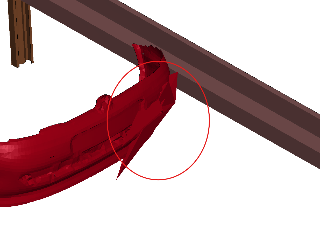

      I have created a bumper and a guard-rail. (I have used similar KEYWORDS like in the Yaris test case.)
      In the time step, where the bumper hits the rail. Big, fast growing cells are produced at the bumper (see red circle).
      Is it weak convergence? What can I do?
      My best wishes & Thank you!
      Frank
    • Nanda
      It seems like an impact test, so probably explicit. There’s no convergence in Explicit. Does the simulation end with normal termination? Most probably this should end up with negative volume error termination.
      Could you confirm?
