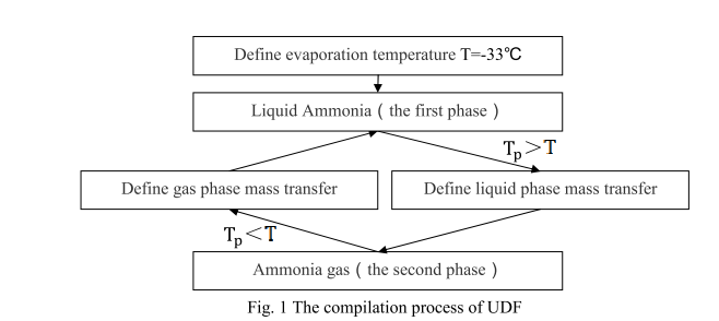

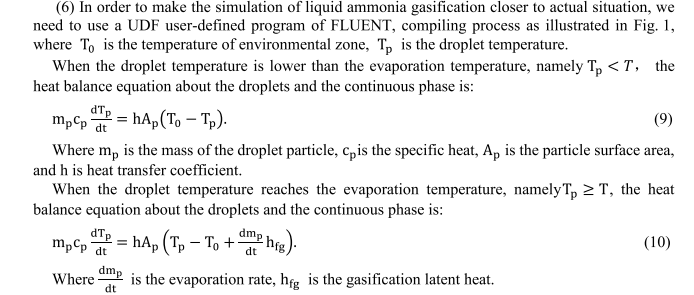

SubscriberThe paper I referred to is:
Xu W, Dong CJ, Li DS. Numerical simulation on influences of wind speed to leaking diffusion of liquid ammonia. Advanced Materials Research. 2015 Jan 27;1073:383-7.
#include "udf.h"#define T_evap -33.0 // Evaporation temperature in CelsiusDEFINE_PROPERTY(gasification_model, c, t){real T_d = C_T(c, t); // Temperature of the dropletreal T_env = C_T(c, t); // Temperature of the surrounding environmentreal m_d = C_MASS(c, t); // Mass of the dropletreal c_d = 2.0; // Specific heat of the droplet (example value)real A_d = 0.1; // Surface area of the droplet (example value)real h = 1000.0; // Heat transfer coefficient (example value)real h_latent = 2260.0; // Latent heat of vaporization for ammonia (J/g)// Check if the droplet is in the liquid phase (T_d < T_evap)if (T_d < T_evap) {// Liquid phase: Apply heat transfer equationreturn h * A_d * (T_env - T_d) / (m_d * c_d);}else {// Gas phase: Apply phase change equation with latent heatreturn h * A_d * (T_d - T_env) / (m_d * c_d) + h_latent;}}DEFINE_DPM_FORCE(droplet_force, f, t, c, dt){real u = C_U(c,t); // Velocity of the dropletreal v = C_V(c,t); // Velocity of the dropletreal w = C_W(c,t); // Velocity of the dropletreal gravity = 9.81; // Acceleration due to gravityreal drag_force = calculate_drag_force(u, v, w); // Call function for drag force calculation// Additional forces like Brownian, added mass can be defined herereturn drag_force + gravity;} -
