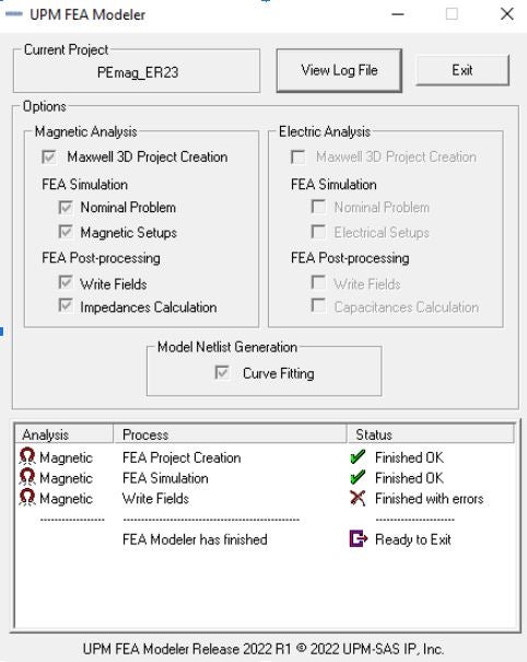

SubscriberI have constructed a planar transformer using PEmag, of which I was able to generate a 2D FEA model. However, when I now try to generate a 3D FEA model I get the following error when the process reaches 'Writing Fields'.Â
Ansys Electronics Desktop Version 2022.1.0, Build: 2021-11-22 22:18:25
Location: C:\Program Files\AnsysEM\v221\Win64\ansysedt.exe
Description: Error in performing operation.
Line(40): Â " Â Â oModule.CalculatorWrite "J" + CStr(w1 + 1) + "_" + CStr(f + 1) + ".reg", _"[Exiting application]
-- Message Window --
   *Global - Messages
    [error] Script macro error: Script Error (Code 80070213) in file:  C:/[...]/PEmag_ER237.pjt/WriteFields.vbs Description: Error in performing operation. Line(40):  "   oModule.CalculatorWrite "J" + CStr(w1 + 1) + "_" + CStr(f + 1) + ".reg", _"Â
I looked into the Help functions of PEmag and browsed the internet to find a solution, unfortunately to no avail. Let me know how I can prevent this error from occuring.

Ansys EmployeeHello bram.oudeaarninkhof,
    Could you try an exmaple in C:\Program Files\AnsysEM\v221\Win64\UPM\Examples\PEmag\ ?Â
    Could you run vb scripting? It seems you might not run the vb scripting.Â
    I also suggest to do perfect installation of EM suite (AEDT).
    1). uninstall AEDT completely, and restart computer
    2). Turn off anit-virus and firewall, or other policy to block the installation
    3). "Run as administrater" to install AEDTÂ
    4). Turn on abti-virus and firewall.

SubscriberI got the same error and that, even with a perfect installation

Ansys EmployeeHello Kili,
    What is the error message?

SubscriberHello, the problem is solved, I needed more space on my hard drive. Thank you :)
