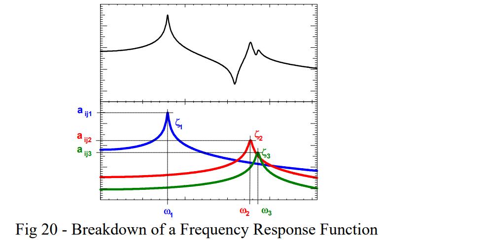

SubscriberHello, can anyone say why the peak on the frequency response of harmonic analysis does not match the natural frequencies of the structure found in the modal analysis? I don not know if it's not right, maybe is correct like this

SubscriberI can't post images, simply the frequency at the peak of response is not one of the natural frequency of the structure, also if is similar. Anyway no, i'm using MSUP analysis, do you think that it's for this, since that is less accurate than full method?Â

What is the frequency of the peak and what are the modal frequencies above and below that?
Here is an article that does a good job explaining experimental modal analysis. Figure 20 give you a hint on how Harmonic Response (FRF) of the structure could have peaks that are shifted from the modal frequencies.
https://www.uml.edu/docs/s-v-jan2001_modal_analysis_tcm18-189939.pdf
