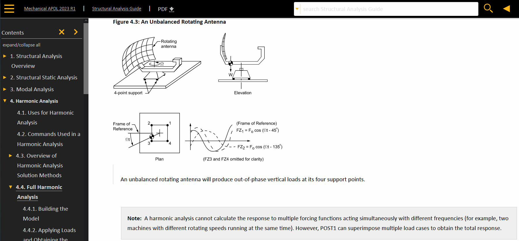

SubscriberGood morning everybody.
I have to do an harmonic response analysis and i have to apply in different places of the structure the same load (sinusoidal) but with a different phase angle. First of all, i see that i can set the magnitude of the load and the phase angle, but how i can set the frequency of the load? Moreover, to set different phase angle between the load, for example 30 degress and more (so 30° load2 ,60° load 3,90° load 4 ecc) how i have to do? ThanksÂ

April 29, 2023 at 11:24 am
peteroznewman
SubscriberHello Claudio,
Harmonic Response supports loads at different nodes having different phases as Samuele saw in the load Details window where there is a field for Phase.
You clarified for Samuele that Harmonic Response is a sweep over a range of frequencies.
I will add that all loads have the same freqency during the sweep, while the amplitude and phase of each load can be set independently. But see the note in the image below.
Here is an example from the Ansys Help Structural Analysis Guide
April 29, 2023 at 12:00 pm
Samuele Luigetti
SubscriberThank you Peter. So the set different phase angle between loads i need only to set different phase angles in the details window right?
April 29, 2023 at 1:42 pm
peteroznewman
SubscriberCorrect
