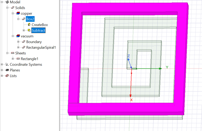

I am trying to run a simulation with a user defined primitive while varying a parameter, I use the optimetrics module but without a clear success.
So, I had defined a python script as my userDefinedPrimitive to generate an object and I can run a simulation without any problem. The issue seems to appear when a new variation is set. The message Manager shows this set of errors:

and fail for all the subsecent variations. After this, I can rerun the analyse on the optimetrics and it will start to compute the next variation (width='0.009mm' in this example). but will still fail after.
I am wondering if this error : FormatException is linked with the UDPPrimitiveParameterDefinition2 function.

The simulation is valid for all selected width, in fact the parameter is not on the RectangularCoil1 object, this object is supposed to be constant.
I have tried to run something different using built-in examples: a pair of identical simulation using the RectangularSpiral UPD in Maxwell. If I use RectangularSpiral (Python) I got a similar error, but if I use the provided example RectangularSpiral (DLL) everything works fine, all other parameters are identical. It looks like there is something missing for user defined primitive using Python an it makes optimetrics crash on the second attempt. Is there a way to use python to generate primitive or I must create a DLL (but this seems tedious)?
