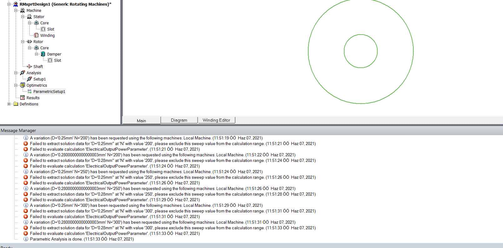

What variables are you parameterizing? What is D and N variables mean?
Provide some screenshots of how you set up your parametric.
Regards Navya
June 11, 2021 at 8:10 amFaraday
D means diameter of winding
N means number of turns but you didn't understand the problem because there is no relation between parameters or parametric setup and the question that i asked about.
I already uploaded screenshots in the first comment, please look them again. There is a problem on "Calculation Expressions". When RMxprt gives results, it share with the name "Electrical Input Power" because it is a motor not a generator. But in the parametric setup calculations, there is no "Electrical Input Power" expression. Also there are problems in some expressions, I just focused on the Power expression due to tell the problem. I use 2020 R2 version. Just create a RMxprt design and look the expressions
June 11, 2021 at 8:20 amFaraday
SubscriberIs there any option to analyse three phase outer rotor induction motor ? I cant see any outer rotor option in "Standard Machine Type----> Three phase induction motor ". Or is there any solution to fix this problem because I am sure that there is no a mistake that i did. Maybe I can make some scripts to define manual "Calculation Expressions" but i have no idea about scripting. I hope there are some tricks to get proper result. Thank you.
