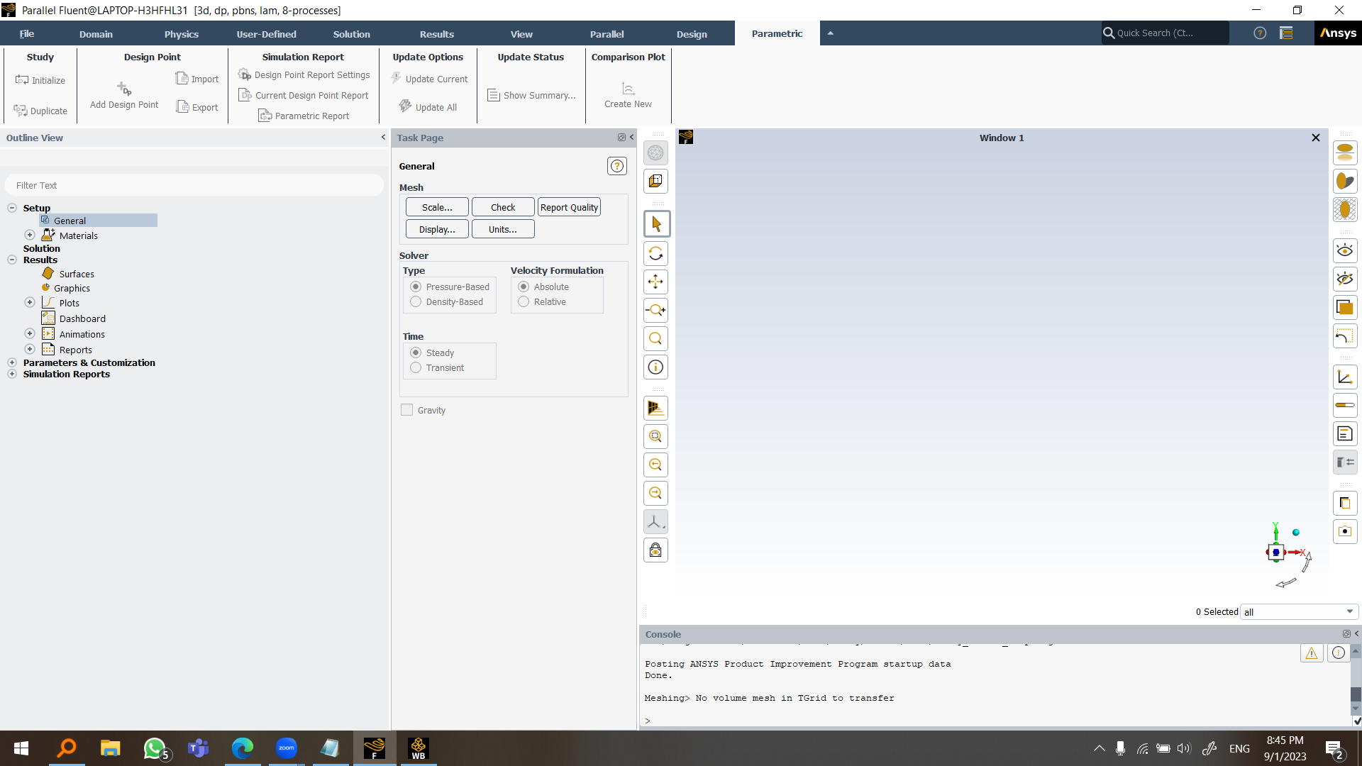

SubscriberHi Julian, could you please share your Workbench Schematic? Also, more information regarding your parameters is needed (what your parameters are, how you define the parameters, etc.). What about running from Fluent "standalone" app? I am using the 2023 R2 and the Parametric tab can be found as shown below.

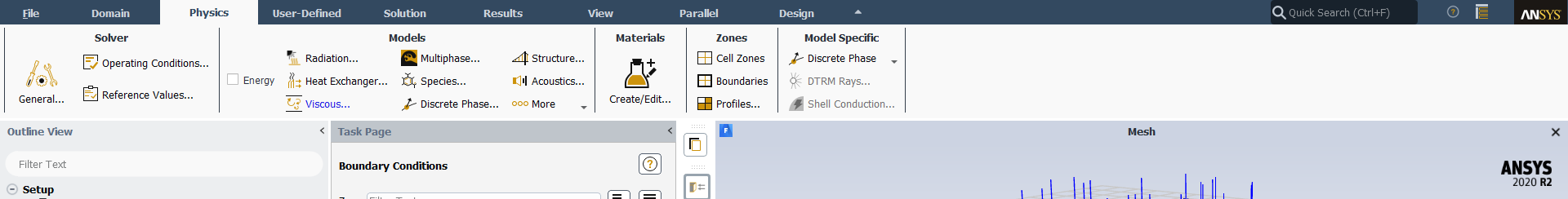

SubscriberI also have no parametric tab in 2020 R2.
