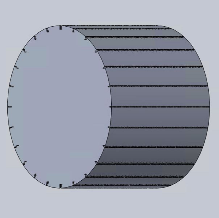

I am modeling species transport in a cylinder that contains internal protrusions at the surface of the wall of the cylinder as shown below.Â

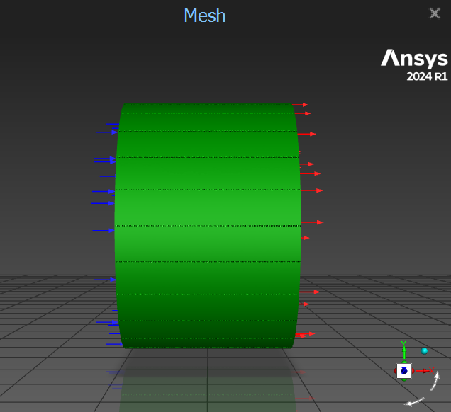

The figure below shows the inlet at the left and the outlet at the other end.

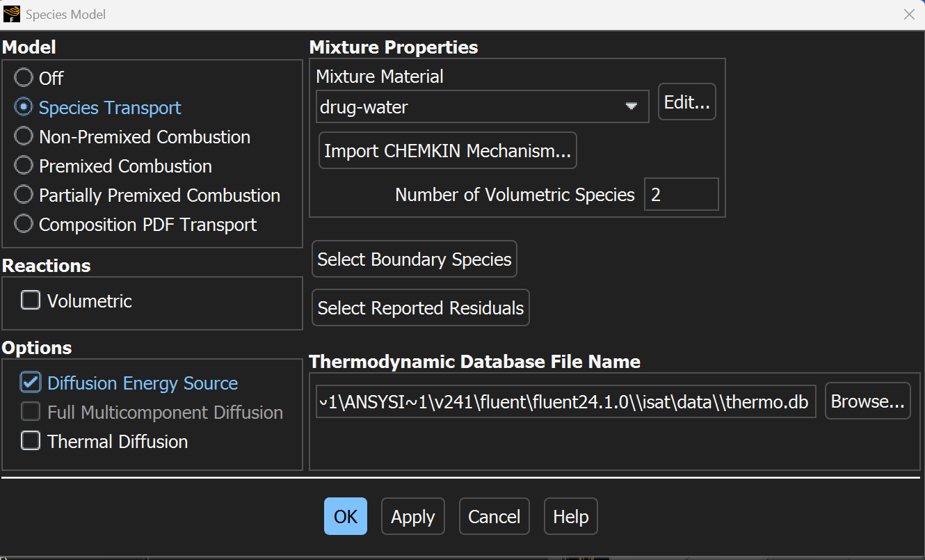

The velocity of the fluid is in the factor of 10e-5 m/s so at first, a steady state fluid flow is solved in the domain so that, there is a developing flow before species transport. The boundary conditions for this model were: velocity inlet, no slip wall and pressure outlet. Once the velocity field has been established, the species transport model settings are turned on as shown below,

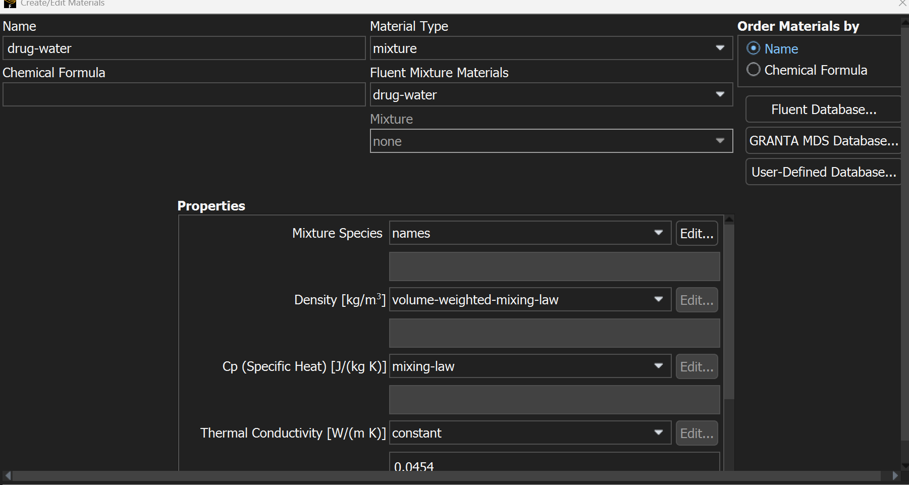

Under materials, a modified fluid called drug is created which is the dissolved species in water. The density is changed to volume weighted mixing law and the diffusion coefficient of the mixture is changed to constant-dilute-appx.Â

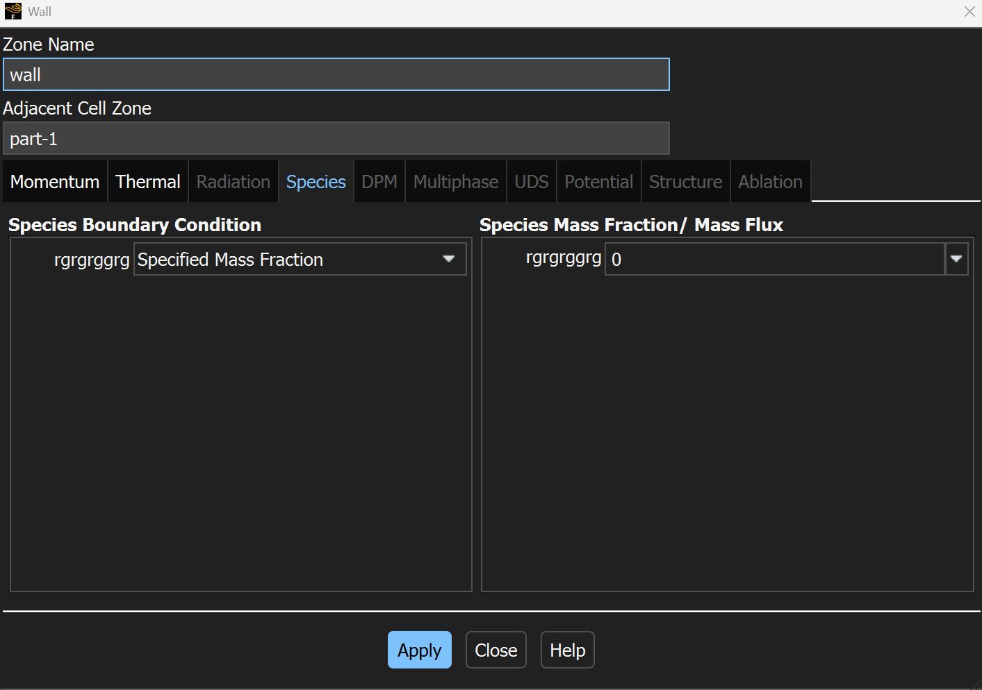

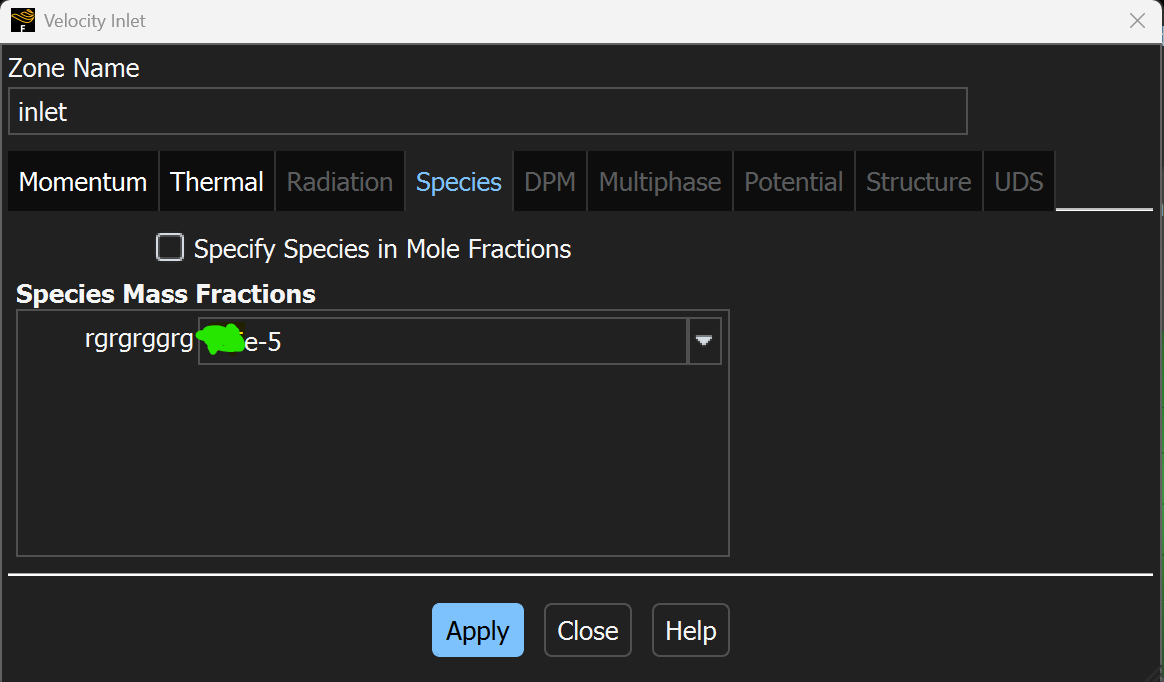

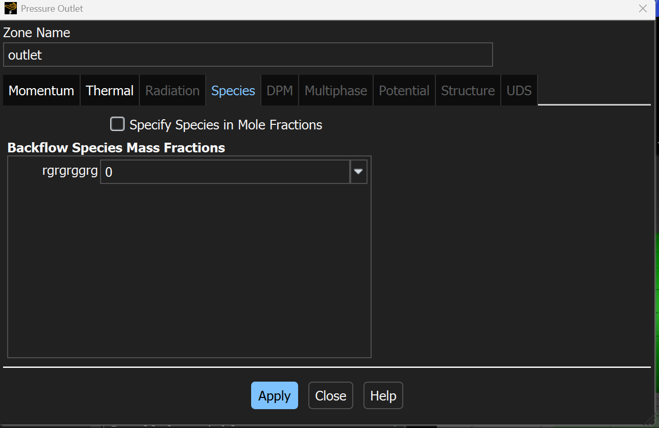

These are the species boundary conditions for the inlet, wall and the outlet. One thing to note here, 'rgrg....' is the chemical formula of the drug which was randomnly named when creating a new material named 'drug'.Â

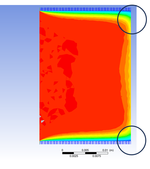

After boundary conditions are set, the species transport along with fluid flow is solved for steady state condition. During the simulation, there was approximately 30% backflow reported at the outlet. After the convergence, this is what the contour plot for mass fraction of the drug looks like:
From the contour plot above, it can be seen that as the drug is transported from the inlet, the boundary layer starts and then I expected it to reach plateau but at the end of the domain it increases as indicated by the two circles.Â

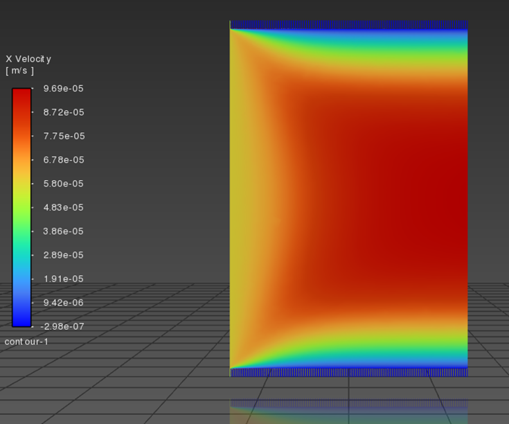

Now, before incorporating the species transport, I had solved just fluid flow in steady state and this is what the velocity contour plot looked like:
ÂUnlike the species transport, the flow becomes fully developed and the boundary layer thickness reaches plateau (visually). My question is, for species transport, what parameters should I change for the model to get accurate results and if the backflow is the major contributor, how can I reduce the backflow at the outlet?

Forum ModeratorThat's boundary diffusion: your flow speed is slower than the diffusion rate. If the boundary is adversely effecting the result you may need to extend the domain. The alternatives involve setting a more realistic outlet species profile using a profile, expression or UDF but that also requires you to know what's coming back in...Â

Thank you for your response. I will go ahead and extend the domain to act as a buffer zone so the outlet boundary condition doesn't artificially warp the results in my main area of interest.
