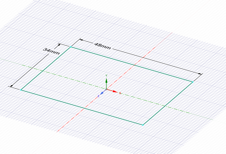

    • charles-web
      i'va already heard a little about that. but i don't want to create groups.
      what i want is to create a sketch, add rectangle with W and H cotation.
      create a parameter somewhere (for example: X=5)
      create an extrusion where extrusion length is equal to W*X and stay linked to these value.
      thanks

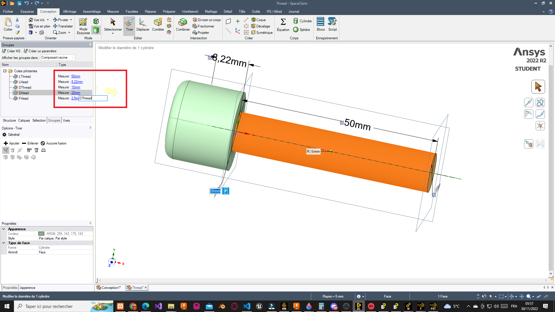

    • charles-web
      hi all,
      is there a  way to do something like to add relationship beetween groups parameters ? (like in screenshot below):
      this way not work
      • Octavio Araujo Mori
        Agree, this feature is needed or at least a simple, clear, straighforward, well documented, and easily accessible workaround for it.
    • charles-web
      no one ?
