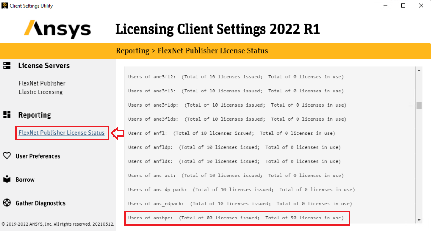

Ansys EmployeeHow many HPC licenses are available to be used?
You can perform a license status by running:
C:\Program Files\AnsysEM\v221\Win64\licensingclient\winx64\ClientSettings\ClientSettings.exe

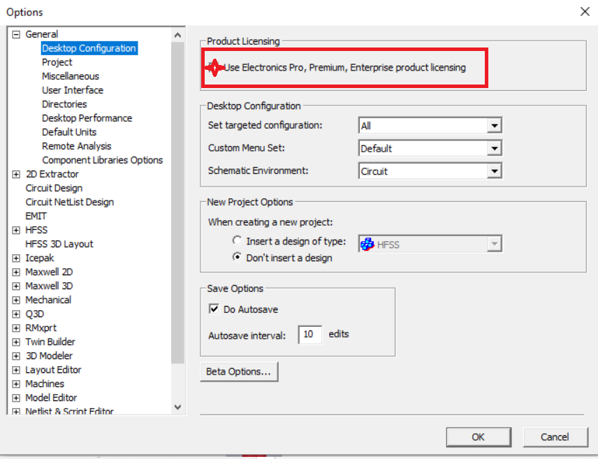

In AEDT, if you look at: Tool->Options->General Options, Verify that Use Electronics Pro, Premium, Enterprise product licensing is checked

This option is indeed checked.Â
