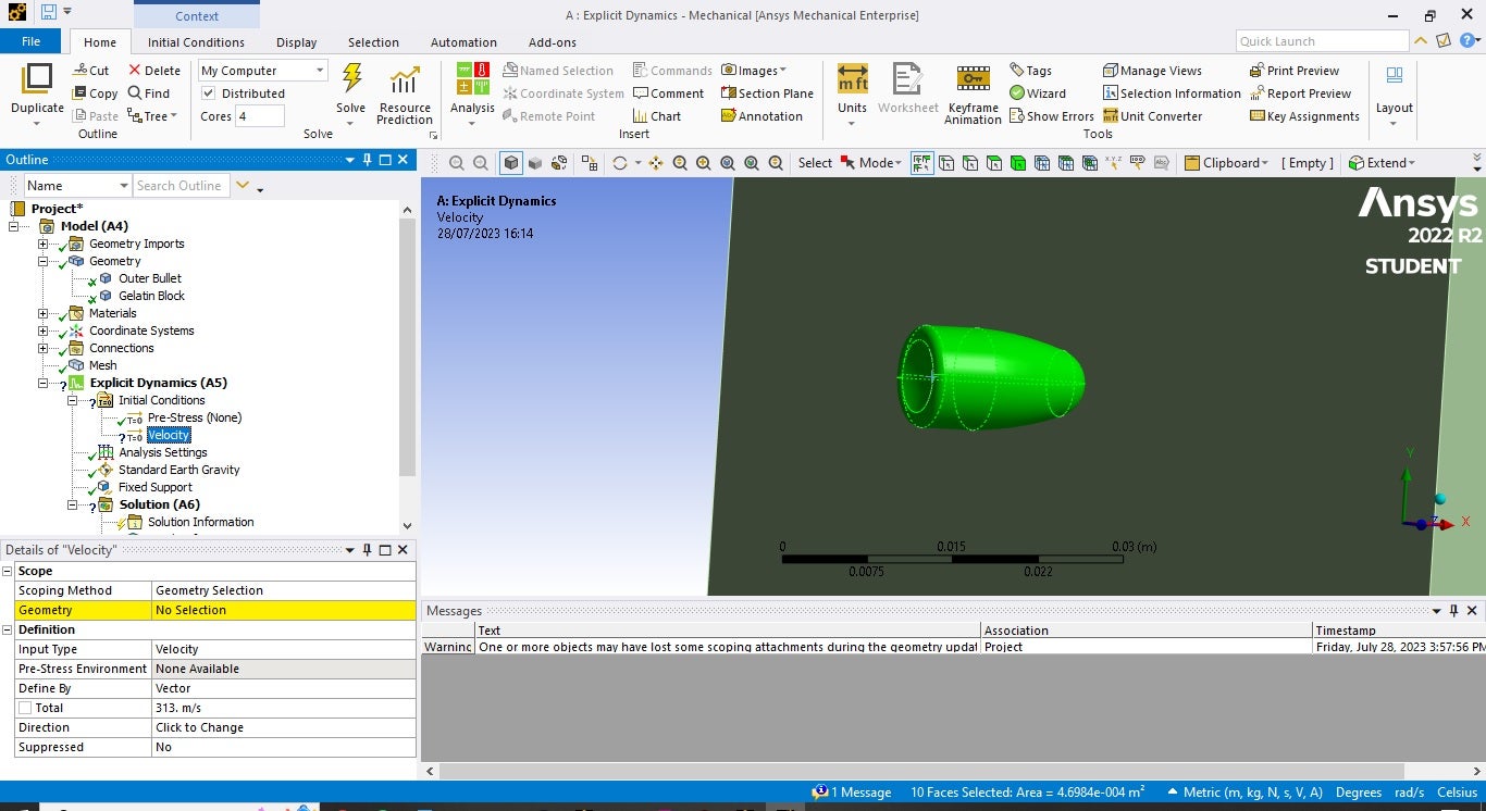

      I am modeling a projectile travelling through a gelatin block but when checking the velocity probe I have attached to the projectile it does not change as it passes throught the gelatin block. why is this?
      Which solver are you using? How is motion defined?
    • James Trudgett
      I am currently using explicit dynamics to compelte my analysis. I have attached a velocity of 313m/s to my projectile as well as adding connections between my projectile and gelatin block. I have attached photos to better explain this.
    • mrife
      Hi James
      You've defined a constant velocity for the projectile.  Instead of that what are the defined initial conditions (if any)?  The projectile should have a initial velocity defined instead.
    • James Trudgett
      Hi Mike,
      Thank you for your help. I have tried to apply the velocty (under the initial conditions section on explicit dynamics) however, when I highlight my projectile (so I can add the velocity to it) it won't let me. Do you know why this may be happening. I've attached a photo to show the issue as well as the other inital conditions I have applied.
    • mrife
      James
      Looks like the faces of the projectile are selected (1); please instead select the project tile body (2) and apply:
    • James Trudgett
      Hi Mike,
      Thank you for your help. The velocity is now changing as it passes through the block
