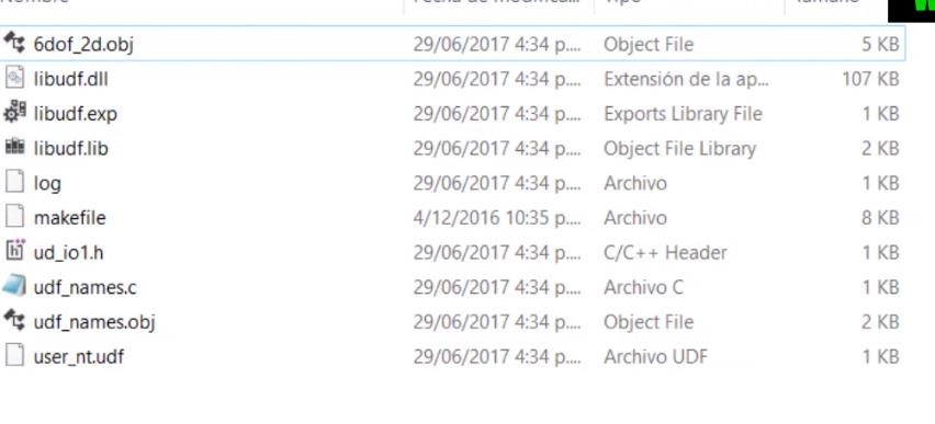

      Hi, I am facing problem loading my udf. I am using Ansys 18 and VS 2012 professional
      When I load my source I am supposed to get the files as on the picture, however I only find: Log/ makefile/ ud_io1/usr_nt.udf  in my libudf folder
      I do not know why I can not get all those files and I am really stuck on this step.
      Can you please guide me?
      Thank you
