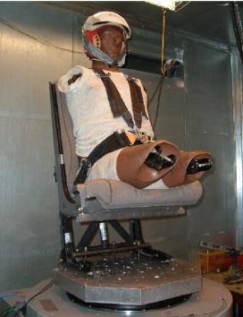

      Here is an image of a seat bolted to the armature of a shaker with a manequin strapped to the seat. The armature is driven by electromagnetic coils that are in the drum and powered by the power supply in the cabinet.

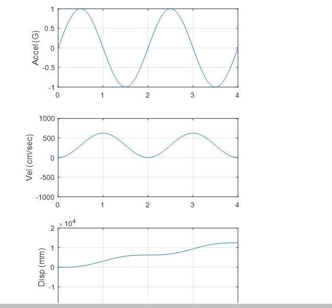

      Here is the deformation result from Transient Structural, 12.2 m of displacement.
      I expect you wanted the displacement or velocity to have a sinusoidal profile, about a zero baseline displacement.
      Peter
      Attached is an ANSYS 15.0 archive that has a Joint Displacement function of a 10 mm amplitude.
      The system solves and here is the resultant velocity.
      Some of the noise in the initial 1 second could be reduced by using a smaller time increment, or adding more damping to the model.

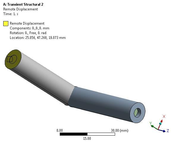

      I tried to put vibration at one end (joint displacement) and hinge support(using remote displacement) at another end. It seemed like I have done everything okay. However, an error is showing which says "one or two elements have become highly distorted." Can you please tell me where I am making mistake? Thanks.
      Hello Masud,
      You have conflicting boundary conditions.  On one end you have zero displacement,
      while on the other end you have a Translational joint displacement of 8 mm.
      I assume you meant to leave the Y axis free in the Remote Displacement.
      You might have better luck with convergence if you just apply displacements to bone faces and leave the muscle to just bond to the bone.
      Peter

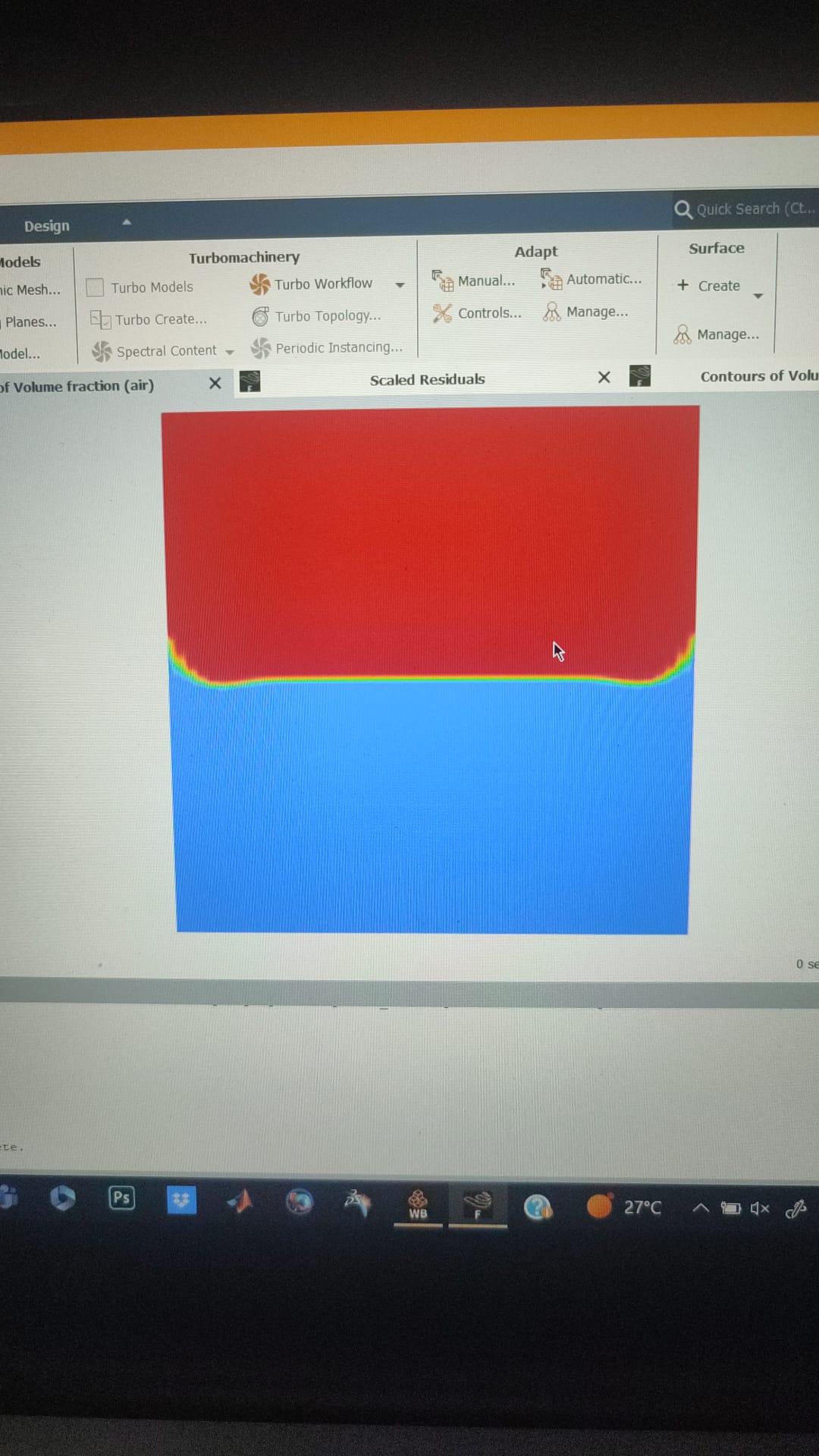

      How to implement a vibrational forcing in fluent!
      please
      I have a 2D model, multiphase, of air and water, and I have to study in microgravity how they behave when subjected to a vibration of 81hz, from below
      How to implement a vibrational forcing in fluent?
      Thanks
