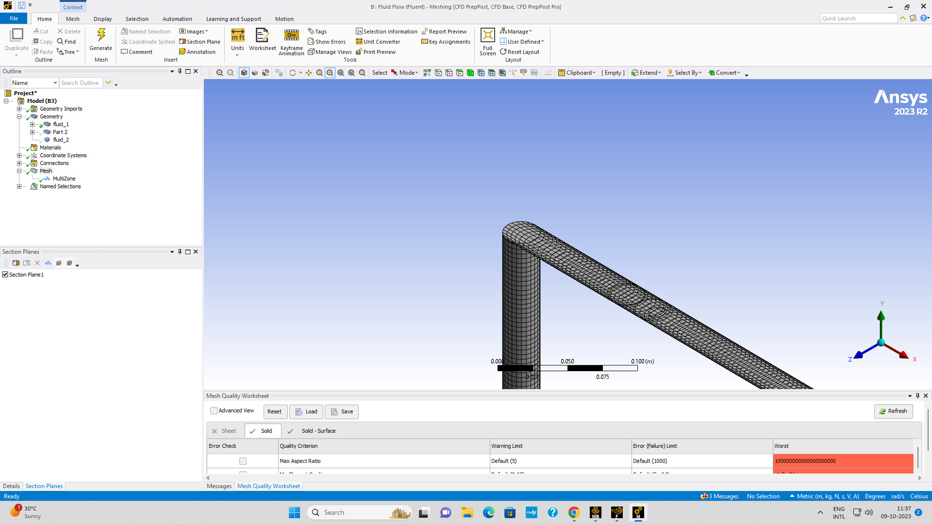

      sir,after doing multizone meshing when i am going to check the crossectional view it is not showing properly. instead of it meshing is comming along the crossection loop in close loop.
      That's impressive. How does the geometry look? You may need to split the zone to have 2+ pipes and an elbow.
