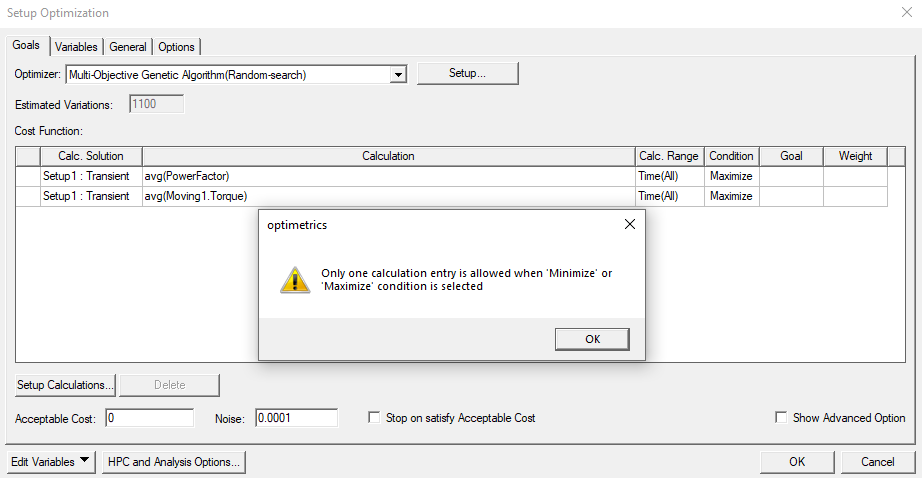

I am trying to perform a MOGA optimization of a permanent magnet machine to maximize two objectives (viz torque and power factor) but I am getting an error that says only one calculation entry is allowed. Does it mean I can only maximize one objective at a time? I thought the whole purpose of MOGA is to allow optimization of more than one objective....Any help will be greatly appreciated. I'm using Ansys 2020R2
October 20, 2021 at 2:44 pmDELI
Ansys Employeethere is only one calculation entry is allowed, when Min or Max condition is used in Maxwell. If you would like to use multiple max/min comparison, you can consider OptiSLang.
https://www.ansys.com/products/platform/ansys-optislang
