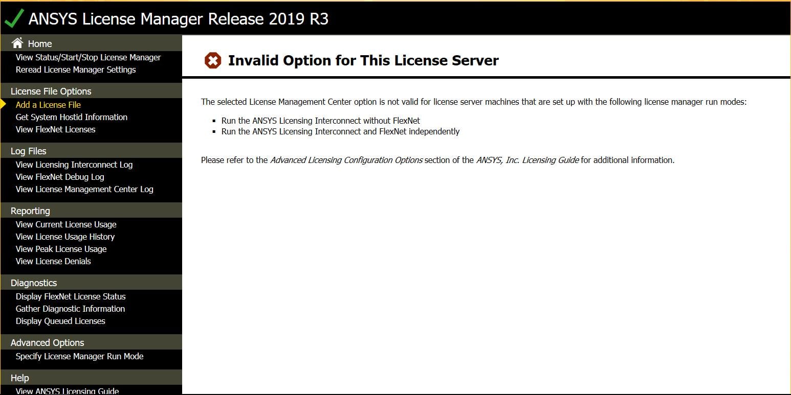

Ansys EmployeeOn the License Manager Run Mode page, select the first option, not last one. Then try again.
By the way, did you request the new license file to reflect your new license server machine information ?
