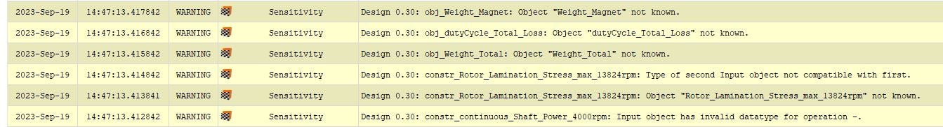

      I am trying to optimise the design of IPM MOTORCAD model by exporting it into OPTISLANG. While doing so , I get the following error. What is the cause of this error.Kindly help

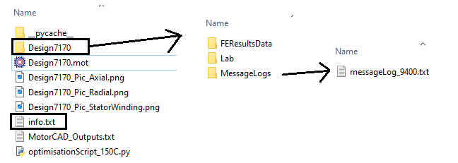

      These warning suggest that the output parameters have not been correction extracted from the sequence of analysis run in Motor-CAD.
      However it is hard, if not impossible, to identify the cause of such warnings without looking at the Motor-CAD log file and optiSLang info/error file in the design directory (see attached). The Motor-CAD log file usually allow to identify whether a calculation went wrong during the sequence of analysis, while the optiSLang info/error file indicates whether the python script failed.
