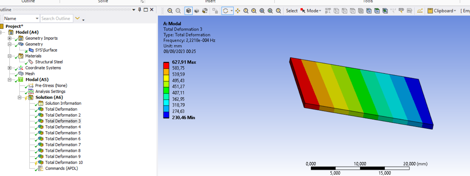

SubscriberAfter having done modal analysis of a steel plate where it extracts the values of natural frequency and vibration modes. I would like to know how to extract the stiffness matrices, mass matrix and vibration mode matrix corresponding to each vibration mode -

Ansys EmployeeHello Massochy,
You can do this by following this Ansys how to video:
Export the ANSYS Stiffness and Mass Matrix to Text Files - YouTube
Also, have a look at this blog for more information. Hope this helps.
APDL Math–Access to the ANSYS Solver Matrices with APDL - PADT (padtinc.com)
Nanda.
Here is the code:
! below commands create dense matrix
! Stiffness
*DMAT, MatKD, D, IMPORT, FULL, file. full, STIFF
*PRINT, MatKD, Kdense.matrix! Mass
*DMAT, MatMD, D, IMPORT, FULL, file. full, MASS
*PRINT, MatMD, Mdense.matrix! below commands create sparse matrix
*SMAT, MatKS, D, IMPORT, FULL, file. full, STIFF
*PRINT, MatKS, Ksparse.matrix! Mass
*SMAT, MatMS, D, IMPORT, FULL, file. full, MASS
*PRINT, MatMS, Msparse.matrixBest,
