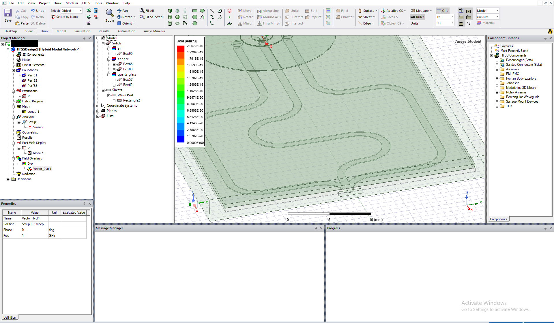

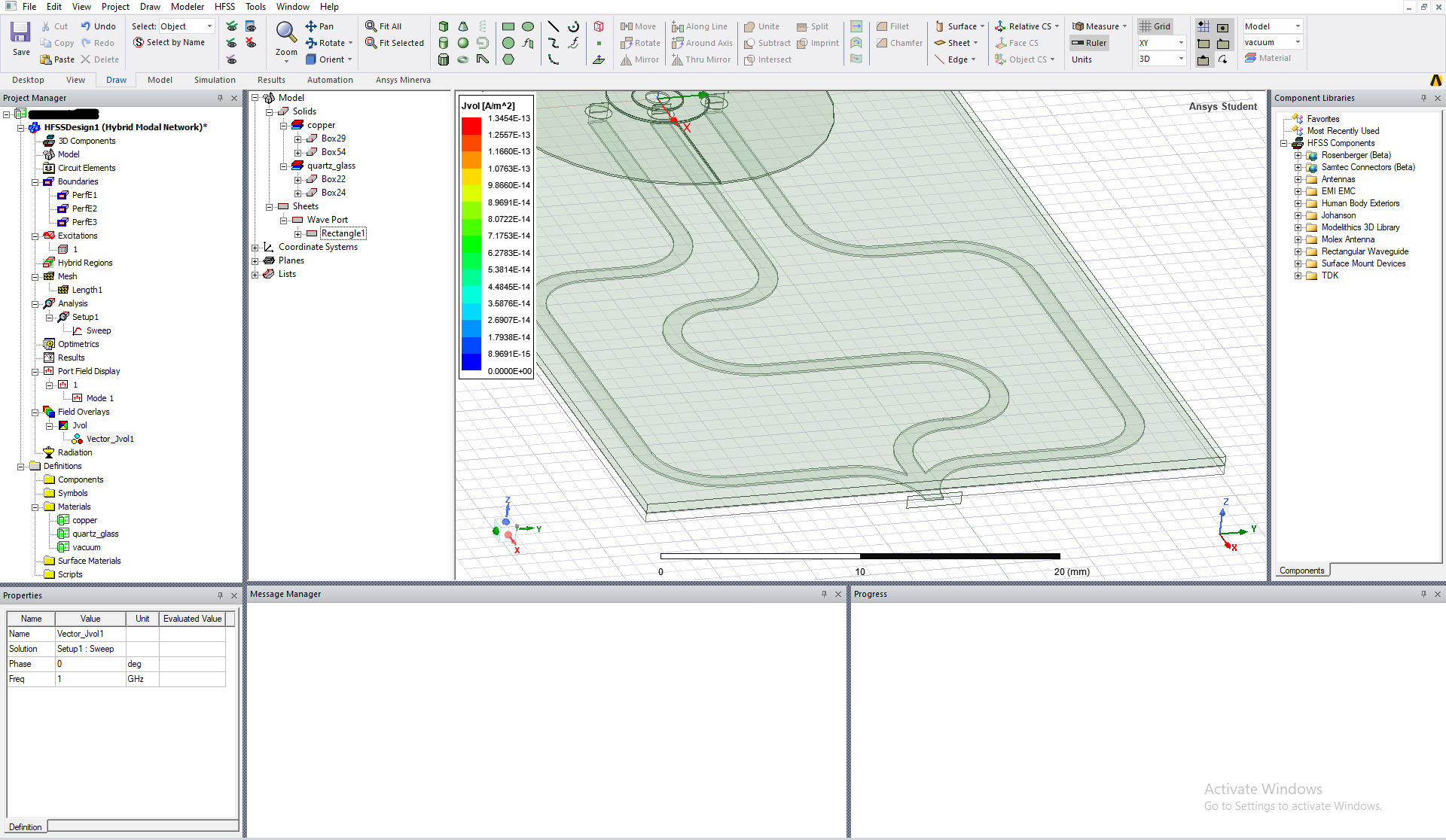

SubscriberAnother problem, maybe linked to previous one.
I have done the simulation now, using wave port instead. Resulting current densities (used in phase determination in lines) are order of femtoamperes per square meter. There are no visible vectors anywhere. Maybe there is some problem with current transfer (should not be)?
I have tried to embed and re-embed the port, change port impedance, integration line, applied radiation etc.

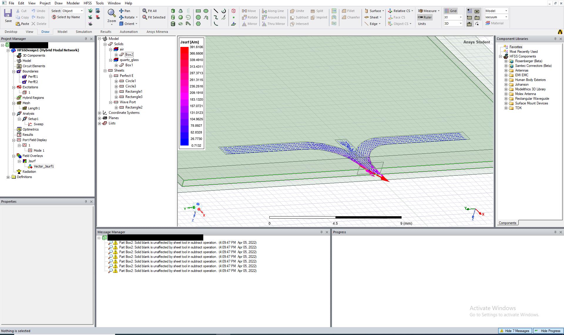

April 5, 2022 at 11:45 amApril 5, 2022 at 12:47 pmPraneeth
I do not see any air region defined in the model tree window. Are you using any auto open region in your model?
Please note that the default material in Ansys HFSS is PEC. It means that HFSS fills PEC automatically in the surrounding areas of your model.
You need to define air region explicitly surrounding your model.
Kindly check if this is applicable to your model.
All the very best Praneeth.

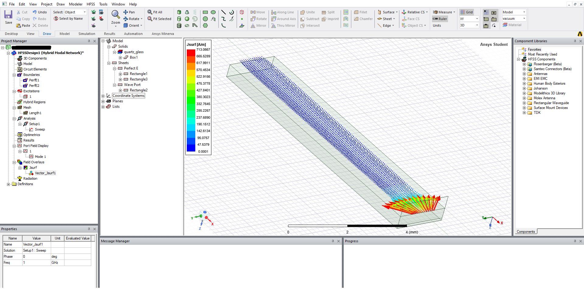

April 5, 2022 at 2:22 pmApril 12, 2022 at 12:09 pmnvl

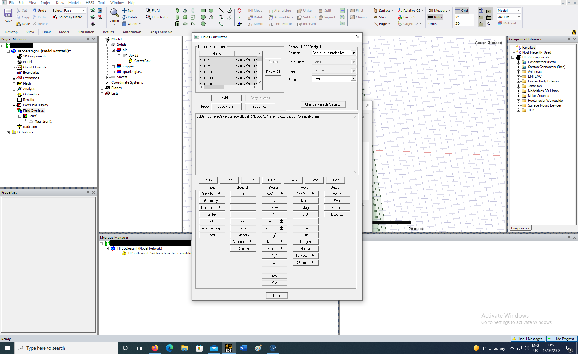

SubscriberI finally made it as partly planar model and calculated electric field in the charged plates successfully. Now I would like to calculate z-component of the electric field. Fields calculator guide advises to use Output -> Plot, but I don't have such setting. When I try to value/evaluate field normal to xy-plane, the response is: "The stack contents are incompatible with the current operation".
