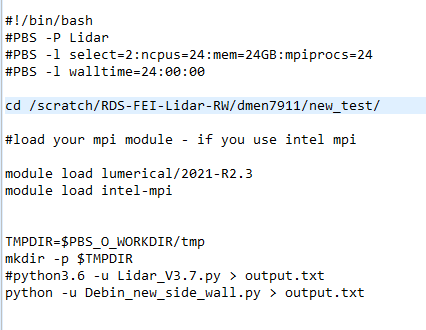

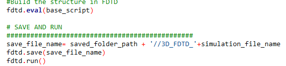

I tried to run Lumerical python API on HPC. The process is:
Running Python on HPC --> Python creates pattern--> Lumerical python API read the pattern and create simulation file through .lsf script ----> Running created simulation file on HPC ---> Python read the results.
For this process, we have assigned 4 nodes with 24 CPUs and 24 microprocessors to the job which are 96 microprocessors and CPUs in total. However, while running the simulation, it will only use 8 microprocessors which results in a long simulation time. Also, during this process, only one "lum_fdtd_solve" will be occupied.
For the other case where we create our simulation file on a local desktop and just use the lum_fdtd_solve to solve the simulation, it will use the whole assigned capacity.
Could you help me with this?

Ansys EmployeeThe Automation/Python API is part of our scripting environment. This will take the resource configuration settings from the FDTD CAD when running the simulation. i.e. the resource configuration set in the CAD/GUI is stored in your user's preference "FDTD Solutions.ini" file. This is used by the script to run the simulation. It will not run using the resources set in your submission script. If you want to use the resources set in your submission script you will have to run the "simulation.fsp" file directly by something like:
mpirun /path/to/Lumerical/installation/bin/fdtd-engine-impi-lcl -t 1 simulationfile.fsp
Otherwise, set your resources in the CAD/GUI and run the python script from the FDTD CAD/GUI. See this article for details: Lumerical job scheduler integration configuration (Slurm, Torque, LSF, SGE)

Thank you for your reply. Unfortunately, we don't have CAD/GUI capability on our HPC. We use pyvirtual display to make the process working for lumapi to create .fsp file on HPC and run it. Is there any other way we can make the process working on HPC and assign the correct node number and microprocessor to the job?
November 15, 2021 at 10:44 pmLito
Ansys EmployeeAs you are using a virtual display and scripts on your cluster you can also set your resources via the script which will save your setting into the "FDTD Solutions.ini" file into your user/.config/Lumerical folder.

Ansys EmployeeTry to upgrade to the latest release, 2021 R2.4. We have seen some issues with 2021 R2.3 on Linux without a GUI or X-server. Running the Python script is done through the GUI and set the resource as shown in this article in our KB when using a job scheduler. One thing to check as well is if you can run a "simulation.fsp' file directly using the job scheduler on more than 1 node:
#PBS -1 select=2:ncpus=24:mem=24GB:mpiprocs=24
cd /path/to/simulationfile.fsp
module load lumerical/2021-R2.4
module load intel-mpi
mpirun /path/to/Lumerical/installation/bin/fdtd-engine-impi-lcl -t 1 /your_simulationfile.fsp

We are able to assign more than 1 node to the job by directly uploading the simulation file to HPC and running it by submitting the PBS job scheduler-based script. However, if we use python assisted way to run the process and assign more than one node to the job, the simulation will be terminated. Also, since we are using the PBS job scheduler, I am not sure how we can make the process work even we have the graphical node on HPC. The resource setting seems to only support job schedulers in the type of torque, LSF, slurm, and SGE.

November 17, 2021 at 12:08 amLito
Ansys Employee´╗┐@Debin´╗┐,
Are you using 2021 R2.3 when running simulations directly on the HPC/cluster using the job submission script to run on more than 1 node per your message above?
If you are already using "virtual display", you can set the resources in your python script. Run the Python script using the job scheduler submission script and the Python script will do the rest of setting the resource for Lumerical to use when running any simulation file on the cluster using the specs requested on your job submission script.
