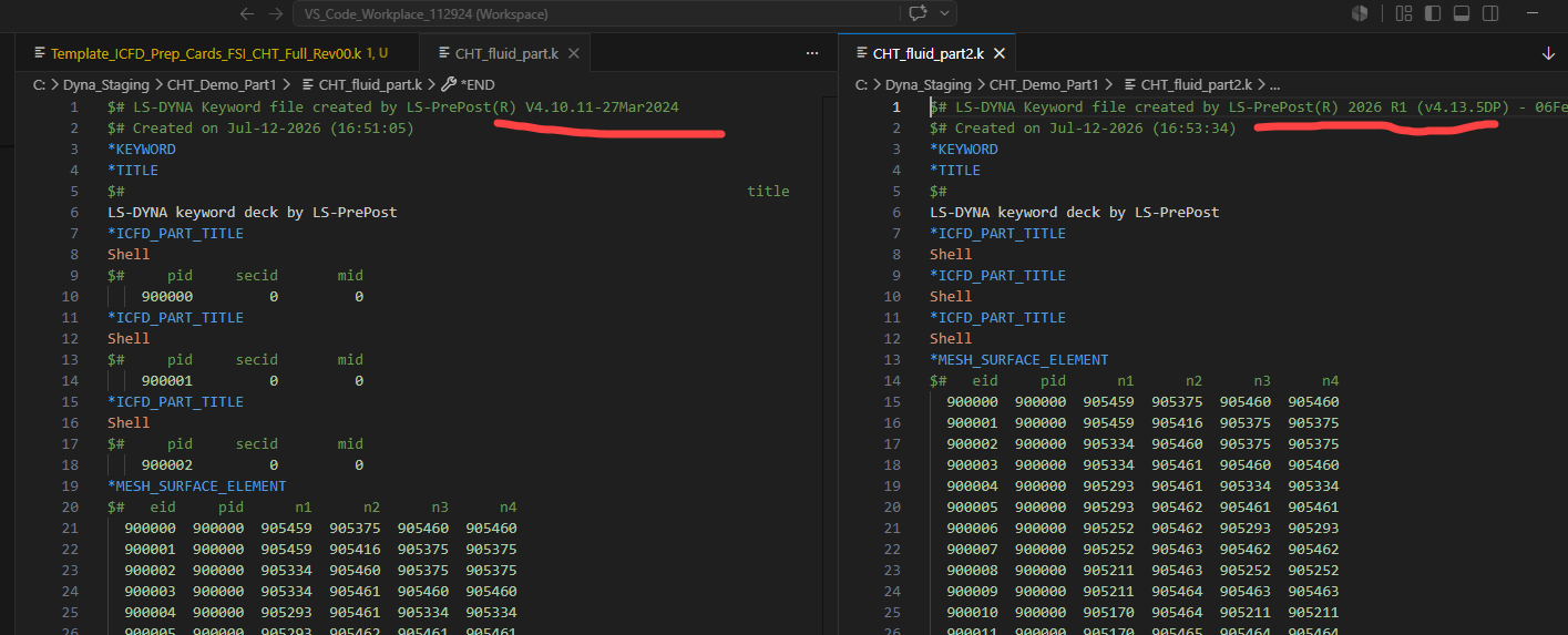

SubscriberBelow is what I see when I export from LSPP ICFD parts after converting mesh to MS Mesh in LSPP 4.13: Also, the newer version of LSPP animation bar won't update correctly (like the bar wouldn't move), also if I try to click on the animation bar from the bar on the bottom toolbar, it won't pop up.  None of these issues occurd in 4.10.Â
can Ansys employee provide some detail as to why LSPP is doing these things in the newer version? Should I just stick wtih the older versions?Â

It is always a general recommendation to use the latest LSPP version. The issue you see may be a BUG in 4.13 version. I can check on that. But in the meantime, please utilise the most recent we have, it can be found under DEV folder here: Index

SubscriberHi Nanda, I thought 4.13 was the latest but I downloaded the 2026R2 version (dev) and see what happens.  Let me know what you find, it is really weird that this is happening -.-

SubscriberHi Nanda, I do still see some random weird behavior in the later version of LSPP like the animation bar not showing up when you click in the menu on the bottom bars.  Overall it's not a big deal, just inconvenient. Â
