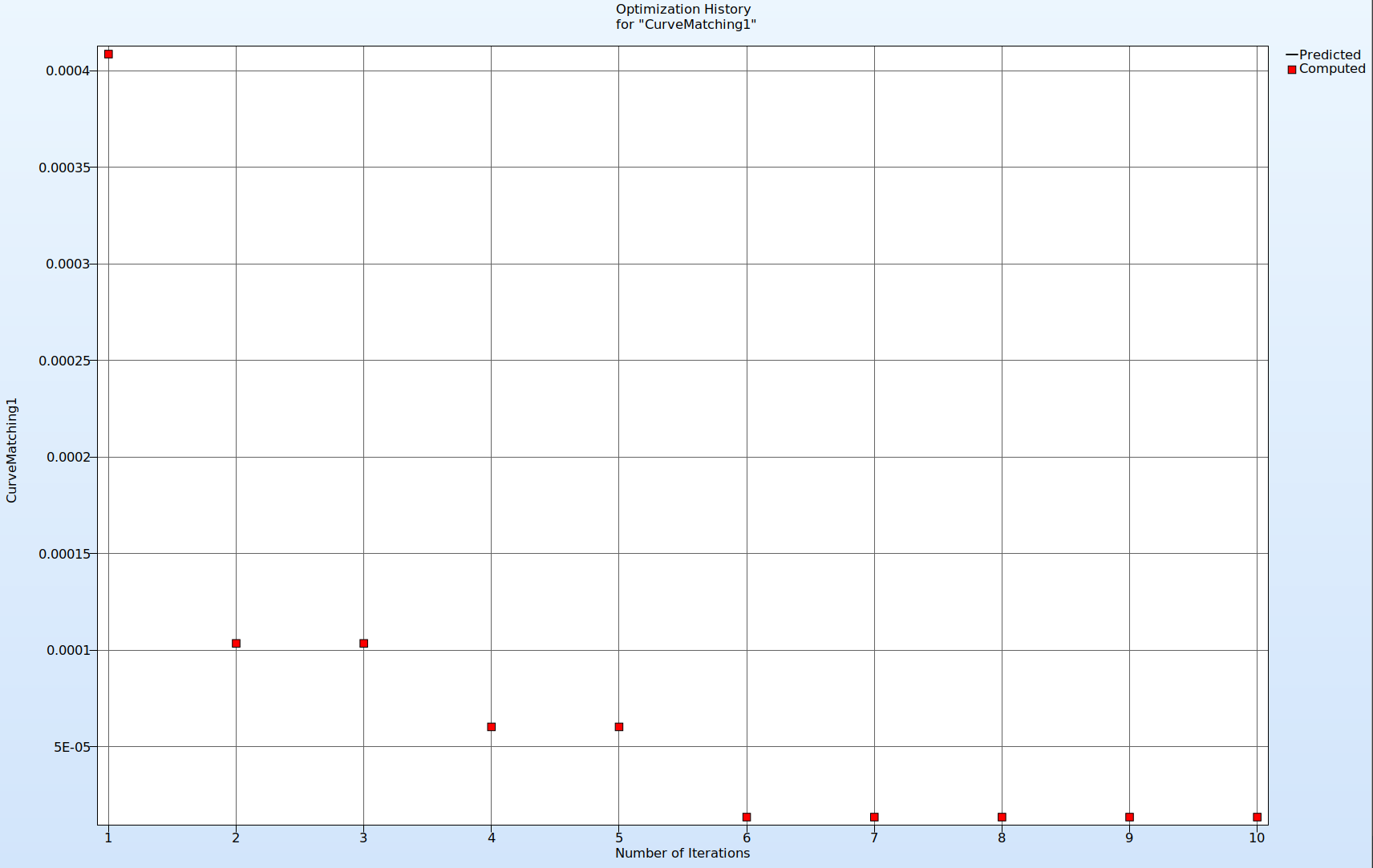

      Hello all,
      I am doing direct optimization with GA algorithm.
      This is how i had defined the Termination criteria.
      Note i am using composites with curve matching (MeanSqErr) as my objective.

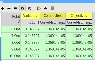

      As per my Termination criteria, it should stop when 3 same optimums are generated right ? (0.1*30= 3).
      but from the picture you can see that it stops after 5 same values.
      I wanted to know how it terminates.
      Thanks in advance.
    • Anirban Basudhar
      Hi Deepak, the internal LS-OPT tolerance for assessing improvement in objective function is 1e-9, which is lower than the digits appearing in the table. Therefore, it is entirely possible that the first change was greater than 1e-9; you just don't see it in the table due to round off. Even without that you would have seen 4 repeated values (1st value + another 3 repetitions).
