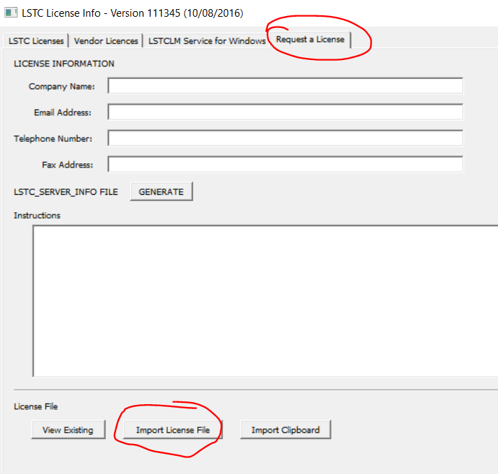

      1st - One day LSDYNA and the corresponding license work perfectly, and the next, the license manager gives an error such as that "Machine ID: X does not match the license file id: Y" (Image 1). Why would the machine ID change on either the machine or the license, and how can I troubleshoot this?

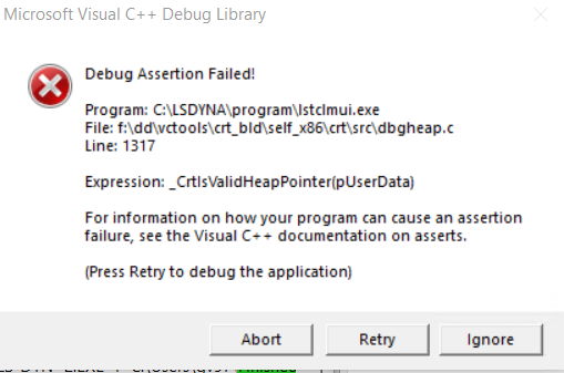

      2nd - The next day, the license manager (lstclmui.exe) won't start, giving a C++ error (Image 2) I was able to access another license manager interface through LS-Run (not sure of the difference) and when I select the "install network license" option and select the file that worked recently on the same machine, I receive the error in image 1.
      Image 1

      The error message you are getting means the hostid of the LSTC license server does not match the hostid in the license file (server_data). To fix this problem, you usually need to do a license server change (sign an LCF form) and get a new license file. Please contact your Ansys account manager to get a new license file.
      Have you installed the program manager? If so, please uninstall it and all LSTC products and use the LSTC license manager on the license server and LS-RUN on the client machine to run LS-DYNA.
      Have you installed the latest LSTC license manager on the license sever? You can download it here:

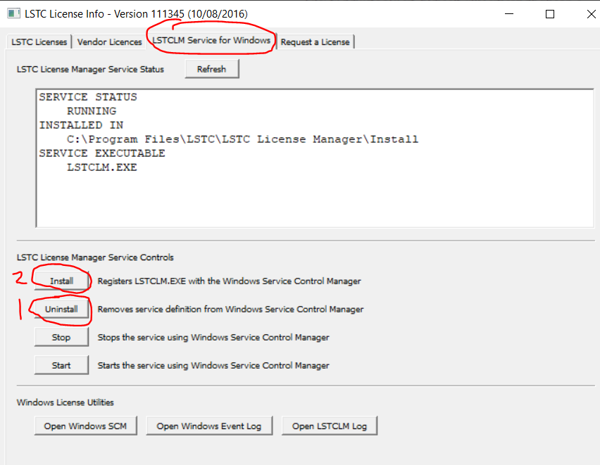

      After installing the LSTC license manager on the license server, run the lstclmui.exe as administrator and uninstall and then install the LSTC service for Windows:
      Then, you can import the license file:

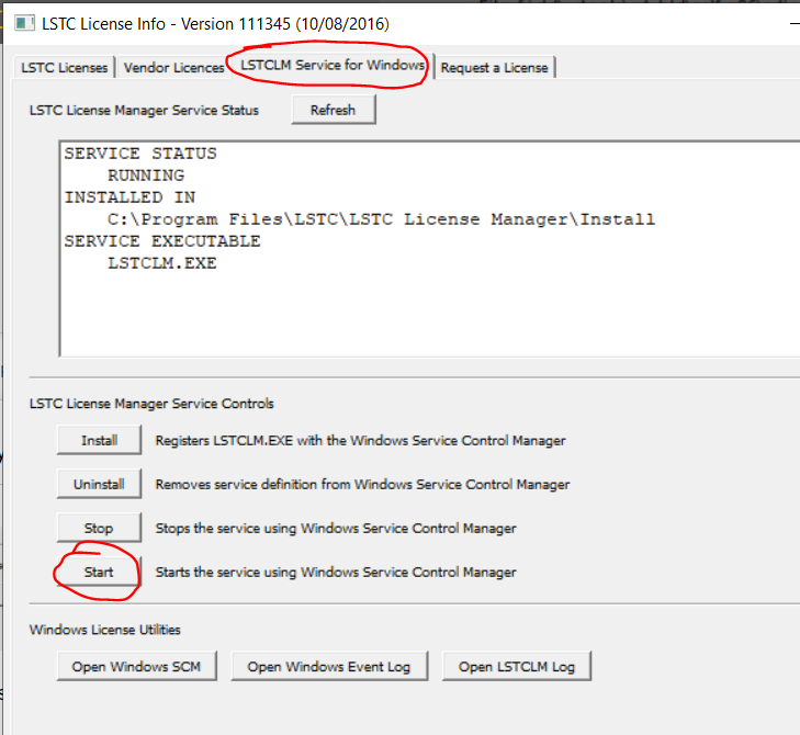

      And start the service:
