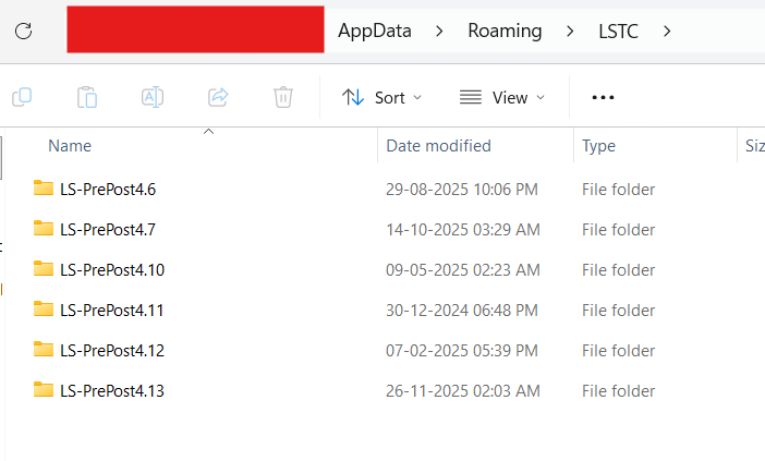

- Open the Run application, and search for “%appdata%.
- A window pops up, and under the LSTC folder, you should see something like below:
- Close all the LSPP windows you have opened, and if there are issues with 4.13, change the “LS-PrePost4.13” folder to “LS-PrePost4.13_old”. You will need to repeat this for all of the problematic versions.
Let me know if this helps.
