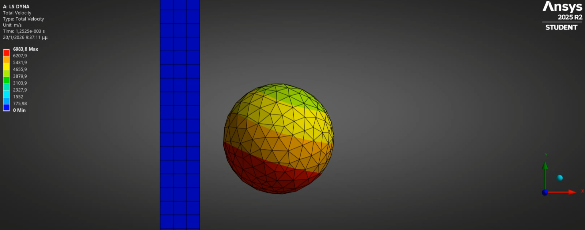

SubscriberHello all, I am having a very peculiar problem attempting to do a simple ball impact on plate simulation on Workbench LS Dyna. I create the model in Spaceclaim, mesh it, select an initial velocity for the ball of 6000m/s, generate a fixed support for the plate and try to do the simulation. However the result is very strange- the ball moves towards the target plate at a very small velocity (maybe 5-10m/s), usually gently turning the other way before it comes near it. This happens if the velocity is 6, 60, 600, 6000, or 600000 m/s. I have tried several times changing different parameters, but still get the exact same result. The thing is this exact same simulation runs perfectly in Workbench Explicit Dynamics with virtually no changes. Below I have posted a video of the problem happening and the .k file of my LS Dyna setup. Any help would be appreciated, cheers.

SubscriberHi, thank you for the answer. Unfortunately coming from Explicit Dynamics Workbench I am not very familiar with the LS Pre UI and layout, and I am only capable of setting up the simulation at the Workbench interface. I will post some photos below to help illustrate my problem better. This is a snapshot of the simulation beginning:

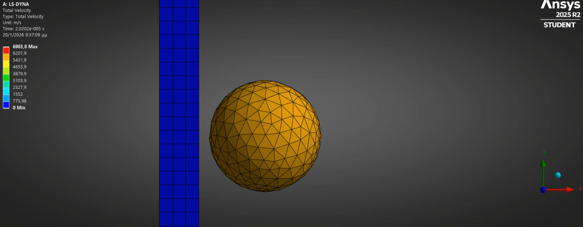

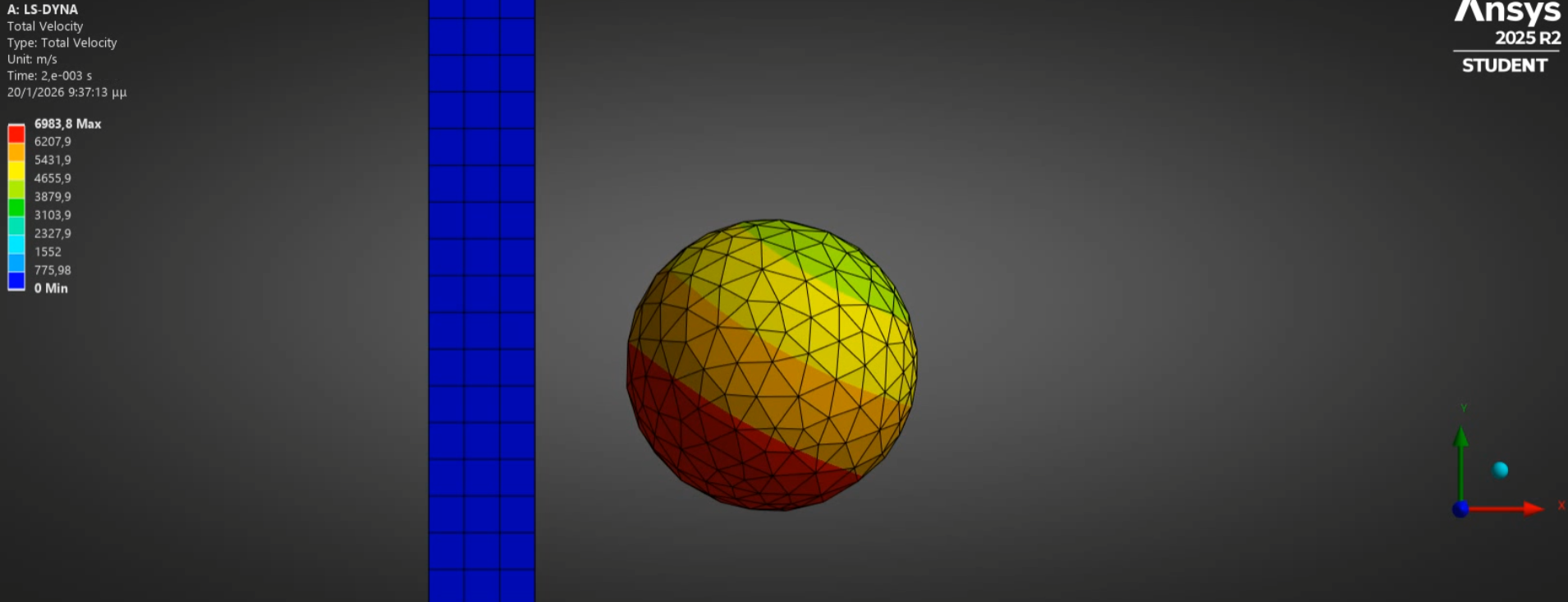

After moving to the left for a very brief moment ( initial velocity is correctly set to the left) the ball changes direction going to the right without seemingly touching the plate:
The balls velocity goes from 6000m/s to 0, then more than 6000m/s in the opposite direction without touching/interacting with the plate. On a simulation where I placed it extremely close to the plate, the ball seemingly clipped through it at a low velocity without interacting with the plate at all. Could this be a body interaction problem? Or perhaps a unit mismatch? Thanks for any advice
