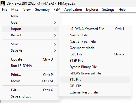

SubscriberFor some reason, I re-downloaded the student version, but it seems to have an import error.
I selected "Import STL file," but it showed as STEP. Selecting OBJ showed STL, and so on for other options.
However, when I switched back from STEP to STL, I still couldn't import the STL file.

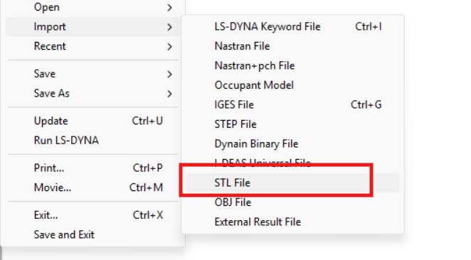

I am using  LS-PrePost 2025 R1 (v4.12.6).
My act: File -> Import -> STL file.

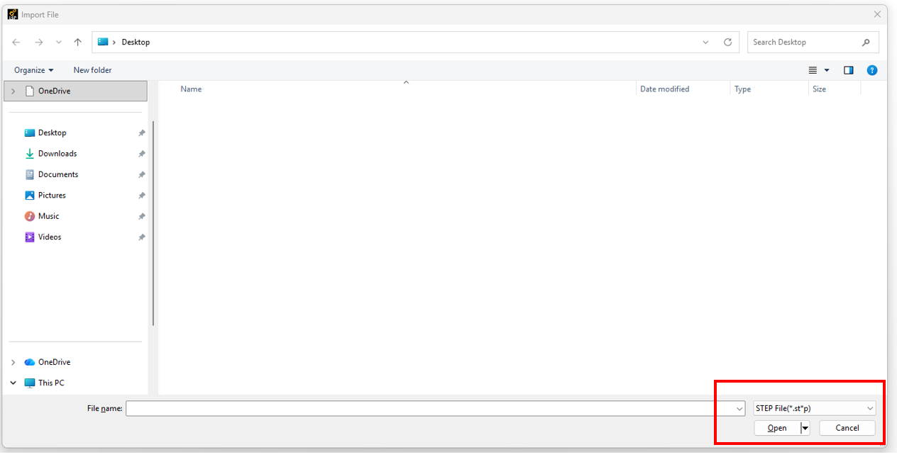

A window appeared showing the file extension, which was in STEP format (*.st*p).

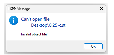

After I changed it back to STL file (*.stl) and selected the file to import, the message that appeared was:
When I press OK, LS PrePost also exit.

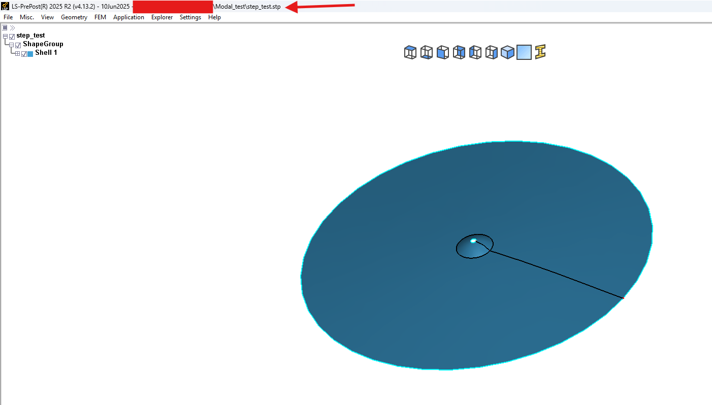

Nanda
Ansys EmployeeHello User,
Currently, I don't have 4.12.6, so I tested this in the 4.13.2 version. I'm unable to reproduce the issue. See below:
I suspect something went wrong during your installation. Could you do a cleaner reinstallation again? If the issue persists, let me know.

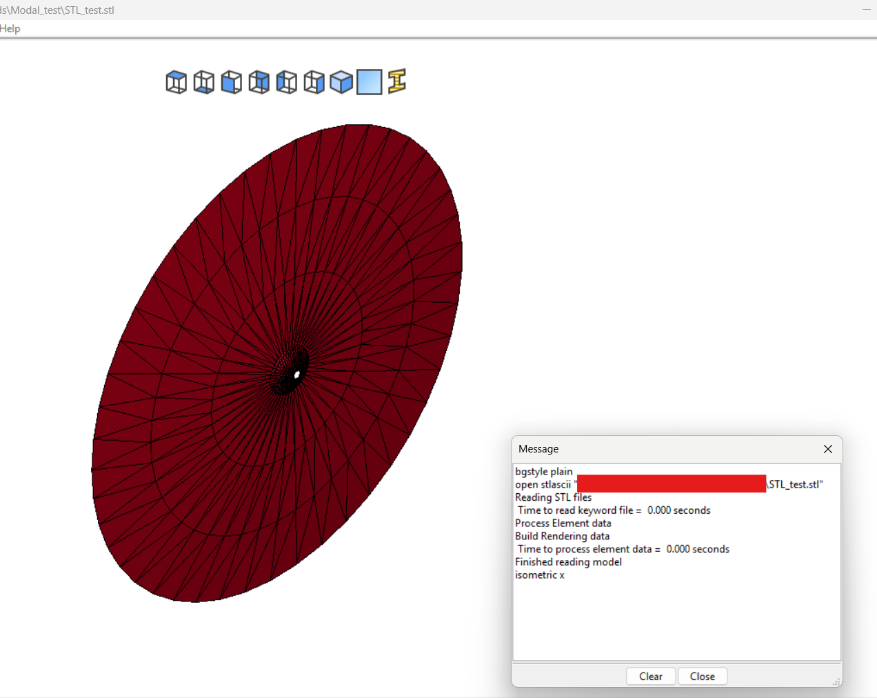

You can check the video I recorded of my PC here:
https://drive.google.com/file/d/1d7RU4e6AgP9OeC5YpxmeZDZpFpLfnD66/view?usp=drive_link
I'm not sure.I have downloaded the software a few day ago. Your version is  4.13.2. is This version newer ?

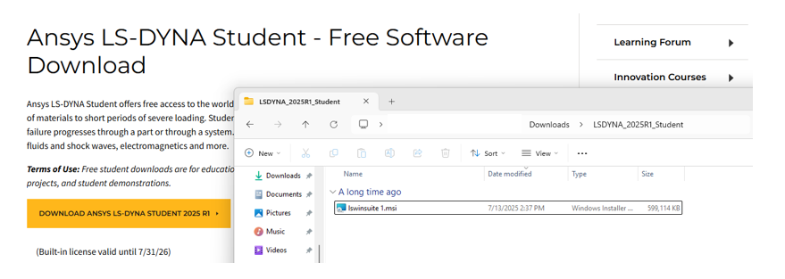

Below is what I do:
1, Download and setup again:
2, I don’t know why, but I can only download this version. Does it depend on the student or license version?

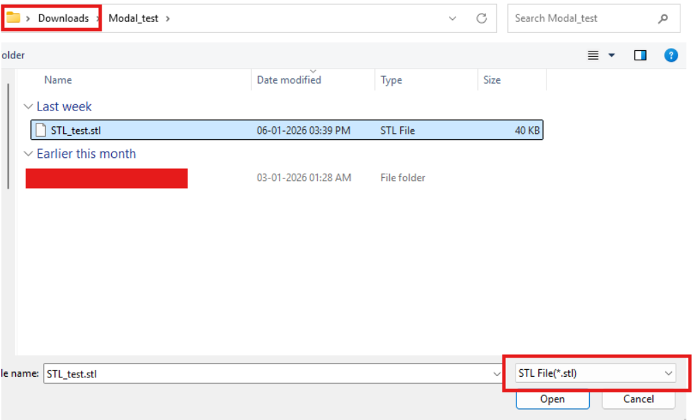

3, Open file:
4, When I choose STL Flie, the file import menu appears, but the file format is STEP.
5, I change to STL
6, choose the STL file
7, But I can not open STL file
Thank you.
