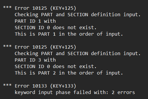

Ansys EmployeeHello User,
Do not use 0 for SECTION ID. Try to assign a unique ID to your section card like 1 or 3 or 22 etc.
Nanda.

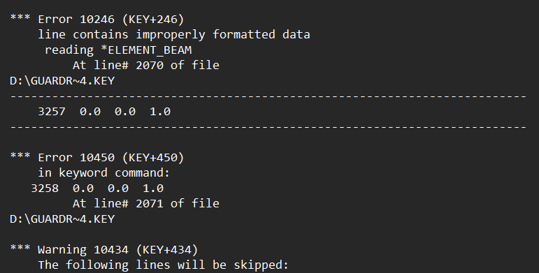

March 11, 2026 at 9:27 pm
willisbara0921
SubscriberI have replaced the 0 with 1 and 3 for both of these errors, but it keeps happening
March 11, 2026 at 9:29 pm
Nanda
Ansys EmployeePlease paste your part and section cards for reference.
Best,
Nanda
March 12, 2026 at 1:06 am
March 12, 2026 at 11:07 am
Nanda
Ansys EmployeeDid you add this keyword manually in the .k file itself? or did you use LS-PrePost or some other Pre-Processor?
March 13, 2026 at 7:37 pm
willisbara0921
SubscriberI added it manually in the .k file
March 13, 2026 at 7:56 pm
Nanda
Ansys EmployeeProbably something went wrong. Could you add it via LSPP?
