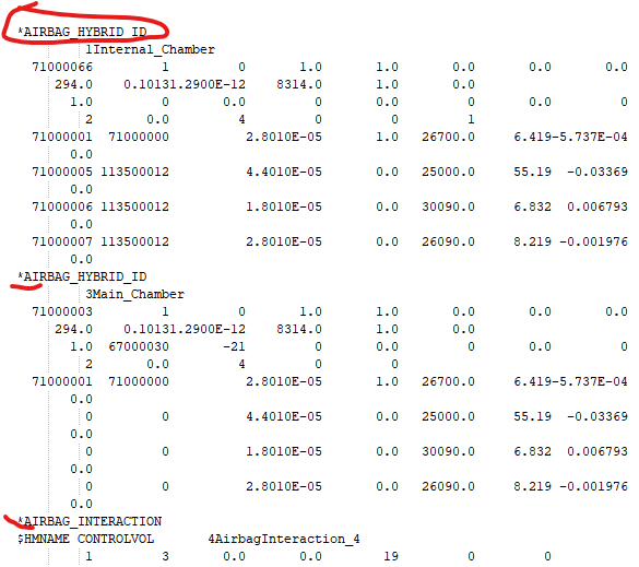

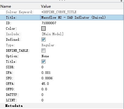

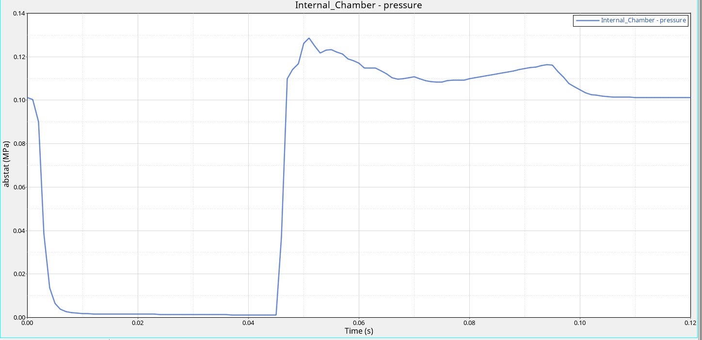

Subscriberi cant understand why my airbag pressure decline to zero in 20ms .The airbag was deployed at 45 ms , i implemented it by defining a delay ,as show in under figure , my airbag's keyword is *AIRBAG_HYBRID .I removed all the components except the airbag, and its pressure stopped dropping. I would greatly appreciate your help.

Could you please share your *AIRBAG_HYBRID_ID card in text format? What do you mean by removing all the components Could you elaborate it more? Also please try to run the model with the latest R16 double precision solver and see If you observe any difference.
Instead of using Offset in *DEFINE CURVE, Could you use Sensor to delay the airbag deployment.You can acheive it by using *SENSOR_SWITCH and *SENSOR_CONTROL.

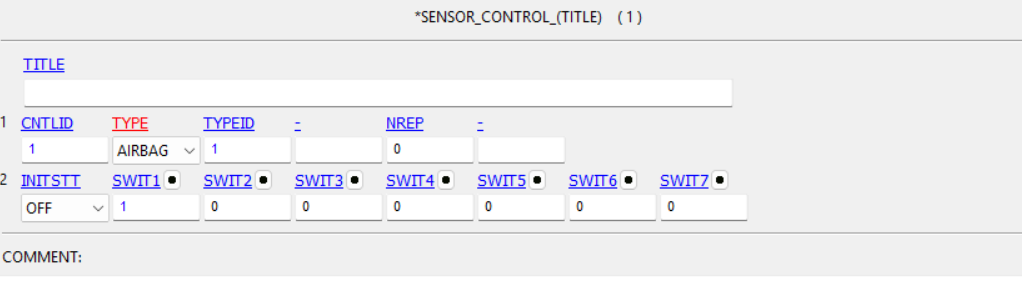

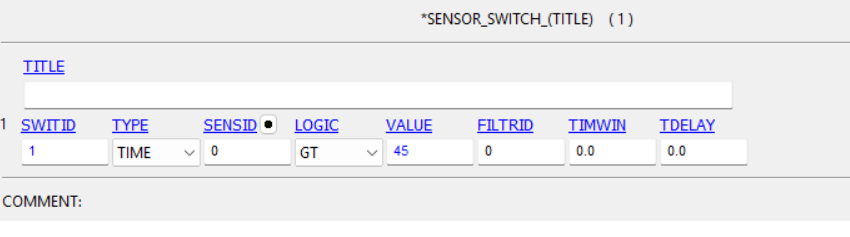

Implementing a sensor is straightforward,you only need to use two cards: SENSOR_SWITCH, which tracks time and creates a trigger, and SENSOR_CONTROL, which deploys the airbag at the specified trigger. Additional details can be found in Volume I of the LS-DYNA manual under Sensors. Please refer to the image below.
Try to implement this in simple model for validation.
