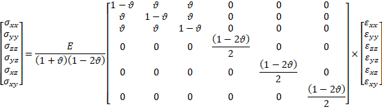

SubscriberIn the course linear elastic material, in the lecture Generalised Hooke’s law-lesson 3 by Mr Bhargava Systa sir when defining stress as function of strain the formula given is
Kindly check the formula and confirm whether it is correct or not.
In my opinion as εxy, εyz , & εzx are representing true strain, in R.H.S in strain matrix in place of εxy it should be 2εxy , in place of εyz it should be 2εyz , in place of εzx it should be 2εzx .
November 3, 2025 at 5:56 pm
mrife
Ansys EmployeeHi Sunil Khabia
Linear elastic is infitesimal strains so engineering stress-strain (not true stress strain). Â
